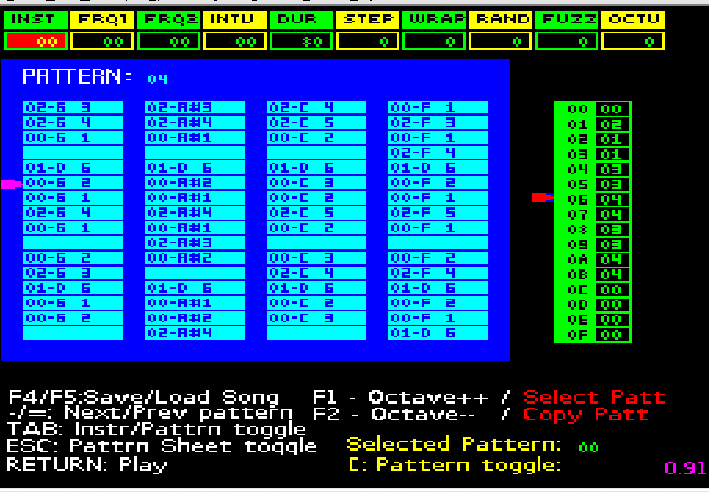

This is interesting to know, but I am indeed an elephant in a porcelain closet; I just want to get it to work on my QL machine+emulator. Indeed, I do move the stackpointer to an absolute address once I relocate the code. In the end this is just a means to an end to make tracks to be used in demos. The UI looks bad and has very limited userfriendlyness; but it works
