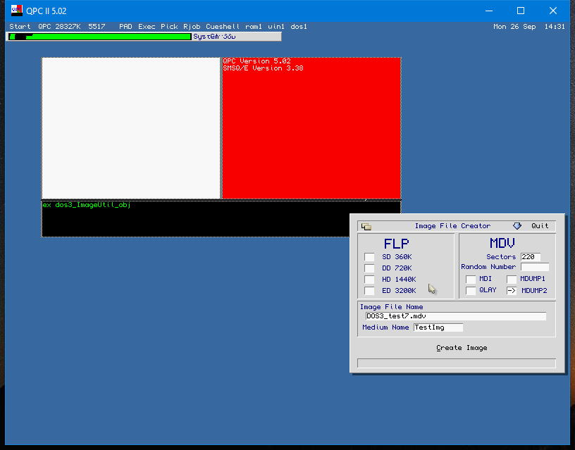

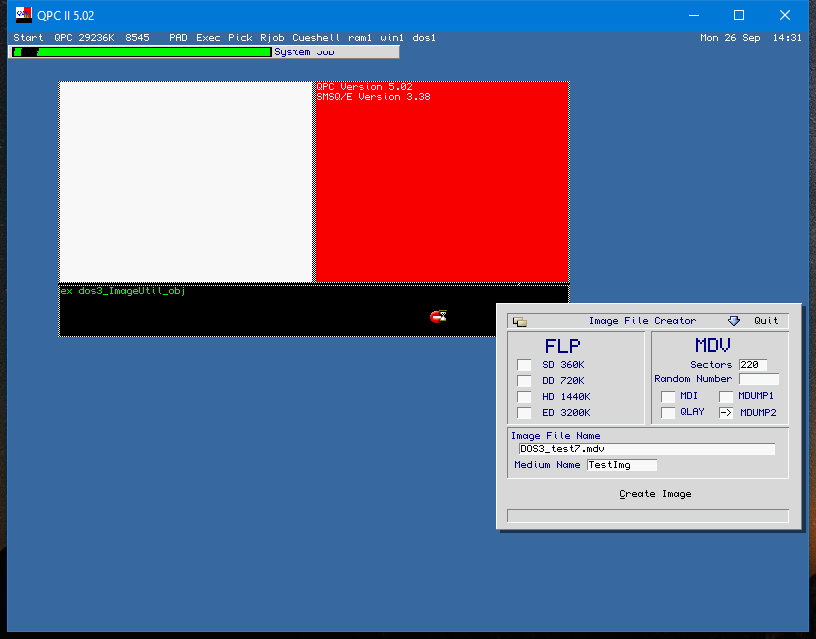

I tried the demo_obj program in vd.zip yesterday, and it did not like running. Threw up lots of errors. But the demo_bas program ran. And gave me the same effects that I see in my program.
I tried -nowinds, without any OUTL command. Which fixes the job switching/screen saving problem. But FILE_SELECT$ gets upset because my programs window is not big enough for FILE_SELECT$.
I tried to reset OUTL before calling FILE_SELECT$, as suggested. But got mixed results, and errors. (the EasyPtr manuals states that OUTL is not possible if there is already a working definition for the channel)
I did at one point get something that kind of worked in SBASIC, but threw up an error when run compiled with QLib. Probably something to do with inheriting an outline from SBASIC.
