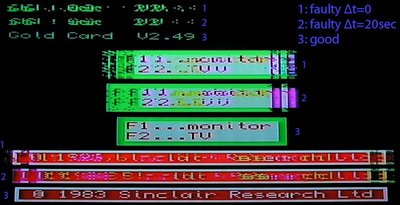

Now the interesting part. After staring at the boards for hours with my nose practically 1 inch away from the chip tops and the multimetre probes in my contortionist hands (you know what I'm talking about, right?) I accidentally connected my Gold Card to the faulty QL (instead of the working one) and turned it on. Lo and behold... it worked. Kind of.
The random green-red test shows... twice... as it should with a Gold Card, then the "Gold Card v2.49" thing... and a second or two later, the "F1...monitor, F2...TV, Sinclair Research etc." prompt. Only, rather garbled, as you can see in the following image:
Comparison of outputs.
So, it looks as if there's a "feedback loop", roughly 4 times. [please forgive the horizontal stretch, the TV I used was set to "widescreen"] The funny thing is, you can see bytes being overwritten slowly, so the image settles after 10 seconds or so.
My interpretation: bearing in mind that the RAM is implemented on 1-bit RAM chips, the fact that the general layout of the display is correct (i.e. you can still see the "Gold Card" or the "F1 monitor, F2 TV" pixels being in the right place), that means that the RAM output is, at least, all present. Also, the fact that the display is such, means that the ROM access from the Gold Card, i.e. 68000, is fine, otherwise, it would be reading 'garbage' from the ROM. Now, to me, that looks like... a timing error, somewhere. Given that the (whatever) CPU has access to the RAM array through the LS245 buffer, I was thinking that maybe that IC is malfunctioning, or 'bouncing' its output and producing artifacts on writes. Alternatively, the oscillator feeding the 8301 could be off? Of course, it could always be the RAM chips themselves, but somehow, I don't find it very probable.

So, my interpretation is that up to the 74LS trio that isolates the CPU buses from the RAM buses, the system is fine. The problem *should* be... oh, wait a minute... just had an epiphany!
The end picture shows that data is being shifted/duplicated by one or two addresses : note the duplicate "F1" and "F2" in the image I posted! So, that *could* be a problem with the lowest bit or bits of the RAM address bus, i.e. A0 and A1... which, conveniently, have to get selected one-at-a-time from one of the two '257 selectors! If that chip's specific output is malfunctioning, it could be screwing up the lower bits of the address bus, thereby making the RAM chips writing data coming from the CPU randomly one or two addresses back and/or forth! Which would be a perfect match to the observed artifacts!
1024MAK wrote:In your post, are you saying that the screen display is messed up but improves with time?
No, it sort of worsens with time, as you can see in the screenshot I posted.

Funny you should ask; all this time, while waiting for some chips and sockets to arrive, I wrote a test programme and checked my assumptions. You see, my previous conclusions were drawn thinking in "PC" mode, not in "QL" mode. So I hadn't taken into account how the pixels are stored in the QL's video memory. After I switched thinking mode... it became clear what I had to do.
Funny thing is, with the Gold card the QL is working nicely, except the display issue, obviously.
So I POKEd the video RAM and drew some patterns, while taking more photos from the faulty and the working QLs, to see if I could see any visible patterns.
So, it's clear now that it's the address line A2 that's not working -- or maybe floating so it's randomly registering as high or low.
That can give us some conclusions:
1. Since the A2 line from the CPU is multiplexed with A0 on the 257, and there's no problems with A0 bytes, the output of the 257 is ok.
2. Since the ROM is being read correctly, there's no problem with the A2 line outside the resistor (R74), i.e. CPU and ROM and expansion slot are ok.
3. Since I changed the 8301 and the results are the same, it's not a problem of the 8301.
Therefore, my conclusion is that there's either a problem in the input of the 257, or one of the RAMs has blown its A2 line and is contaminating it with random noise.
