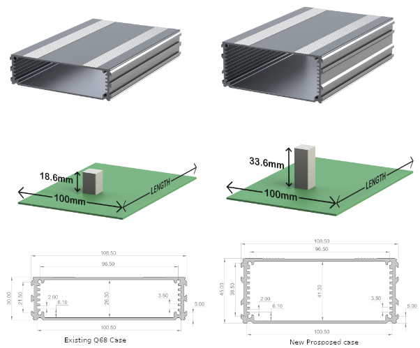

I am considering a slightly larger Q68 case, with added height to accommodate the I2C and QL Net Connectors on the rear end plate, which would save drilling into the case side wall.
The new case would have an added 15mm in height, which would give enough space on the Rear Panel to accommodate the I2C and 2 x QL Network connectors, as shown below: There would be added height space for internal expansion from the Q68 Internal expansion port.
The only real change is the extra 15mm in height, so new end plates would be required, which would solve the paint flaking issues on the Q68 v1.1 case.

The problem with the current Q68 case is the expandability. Adding QL Network connectoins can either be done on the front panel or the side of the case.
I do no like the front panel option, so I opted for the side option. To connect the QL Net connectors to the side of the Q68 case requires 2 x 6mm holes drilled with an 8mm counter-bore to accommodate the connector securing nut,
Inside the case which has rails for locating PCBs, which the Q68 uses the bottom rail. To alllow the QL Net connectors to be secured to the outside of the case, part of the upper rails where the 6mm hole is drilled, must be removed, by milling the excess Aluminium away.
This results in a nice niice installation for the QL Net, but this quite an intesive process. Which I can do with a hand drill and End Mill, but an alternative is a increased height of the case to accommodate the extra connections on the back.

For my two cents, the larger case and rear net connections would be the best option.
