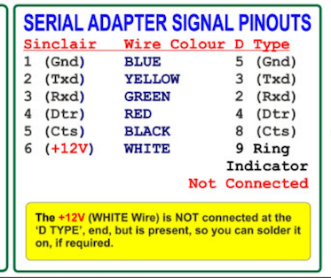

My existing adapter (not been used for anything yet) has the pinout in the image below, which suggests I'll need to re-route the pin 4 from D9 pin 4 to pin 7?

I ended up using the one I already had (as per the image) and it works fine with my WiFi modem (not had a single error as yet, but I only need it running at 1200 to get the time on each boot currently)
