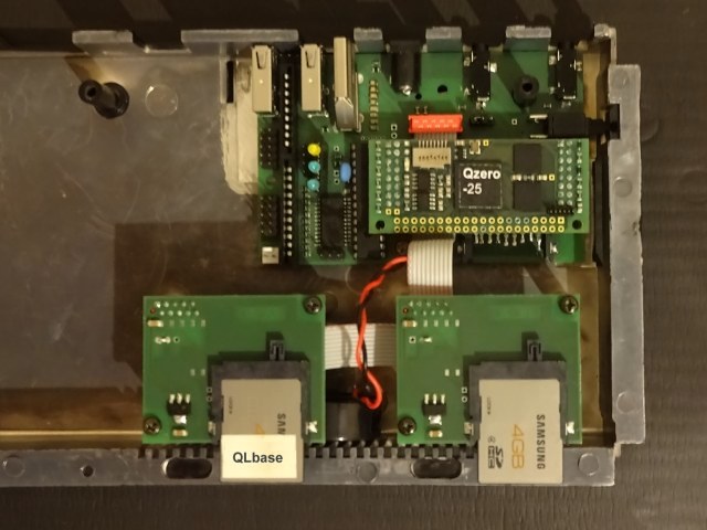

This thread has way too long... Yes the new QL baseboard supports the QL LEDs and their original 6 pin connector (at least the one I have here in my German QL).
The first one is meant as power LED, but actually driven by the Arduino which handles the matrix keyboard. It might end up as Capslock LED instead, if people find that more useful. The other two are used as activity LEDs for the SD card drives inside the microdrive bays.
Posts: 2488
Re: Target for major new QL hardware
The new QL baseboard with Qzero, two microdrive replacements with SD cards and QL speaker mounted in the QL case.

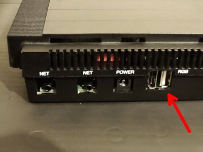

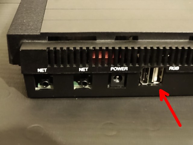

As the issue came up in the Q68 order thread, I'd like to confirm that a QLbase board without Qzero can be used as a toolkit package to operate a Q68 inside an original QL case. The QLbase board provides these "QL helpers" for the Q68:
- QL matrix keyboard interface for the Q68
- Q68 style 5V power supply connector at the back of the QL case
- Dual QL network connectors
- The add-on circuitry (resistors, diode) formerly needed for QL networking with the Q68
- A fix for the Q68 "QL network down on power down" problem
- Support for Q68 sampled audio via the QL speaker
- An integrated mono audio amplifier
- Separate USB mouse connector at the back of the QL case (only combo devices, saves passive USB-PS/2 adaptor)
- Q68 power On/Off switch in place of the QL reset button
- Ribbon cable connector for QL Joystick, suitable for 9 pin SubD
No QL case modding ist needed!
A separate thread for the QLbase board should follow when I find more time.
