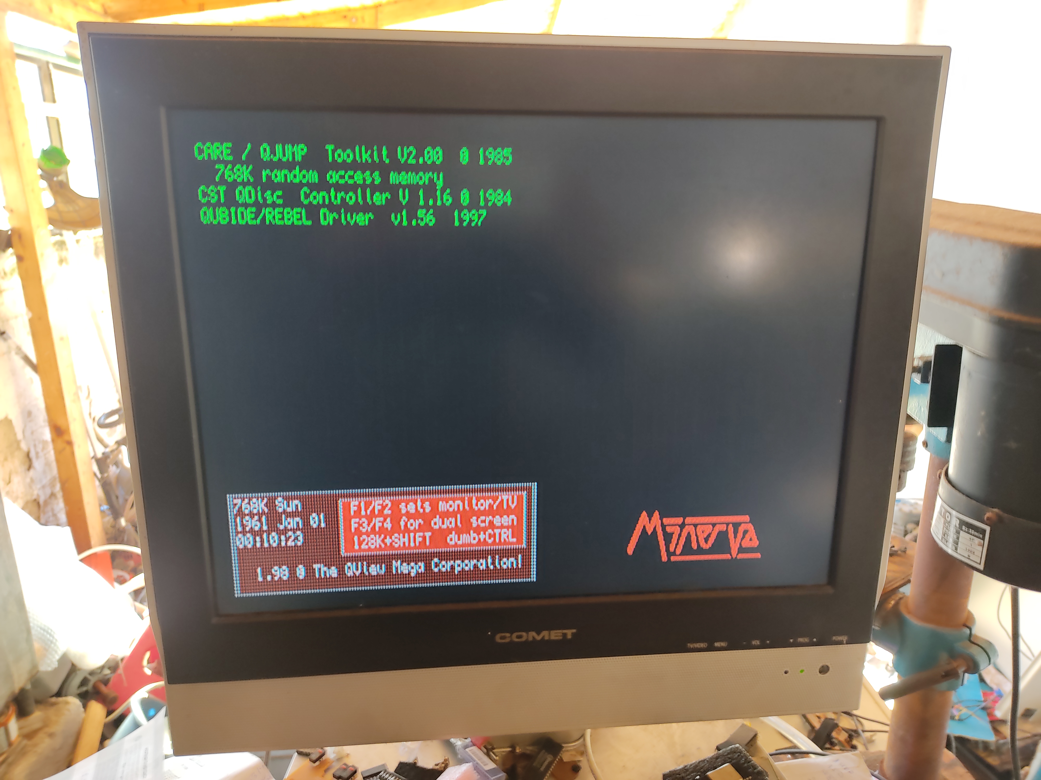

Hi, I made the interface based on the scheme of nikosdoykas, but I have some problems:
If I use the version 1.13 of the rom from the dilwyn, work ok, I do some test with floppy and a gotek and seem to work correctly.
But if I use the version 1.16, the work is erratic, for example the boot part do not work, usually hang, and if I try to load or save a big file, it hang.
Has somebody similar faults? (I was using a WD1772, that is the only one that I have available now).
By The Way, I made a binary compartion between the 1.16 from from CST and the XDISK WOLF-COMPUTER and they are the same ROM file, the only change is in the first bytes, the copyright message that apears when boot the computer.
Has somebody access to a more recent version?
Has somebody the manuals of the interface in PDF or in a PC compatible format?

Well, I have time to do aditional test, and found something interesting:
* The erratic operation with version 1.16 is related with interruptions, so cut the leg 3 of 74LS03 fixed it, curiosly with version 1.13 work ok.
* 74LS03 can be swapped with 74LS38, both are NAND gates with open colector output and identical pinout.
