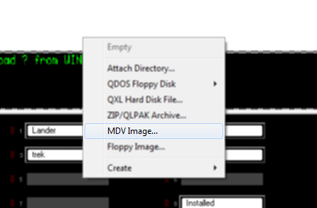

For now I am trying to get a directory on screen from an emulated MD tape image file I found with the QLAY emulator (MDV1.MDV).

Have you tried contacting Daniele Terdina of Qemulator fame, he must have done something along these sorts of lines, as his emulator also reads MDV image file.
http://www.terdina.net/ql/q-emulator.html

Daniele has a much easier job - he just needed to decode a microdrive image.

Interpreting the image and understanding it allows you to know what then to look for, especially if the image contains known data. I am assuming some form of logical process here obviously.
