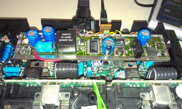

The power supply:
The 'new' power supply
The 78S09 is used to lower the unregulated input voltage for the microdrives and its motors.

Impressive work! Do you think the new power supply works better than if it used the old sinclair one?

Post by gertk »
vanpeebles wrote:Impressive work! Do you think the new power supply works better than if it used the old sinclair one?
After a night running a Basic program the powersupply board was about 30 degrees Centigrade, the adapter in the power socket about the same so it is definitely more efficient.
The LM2575 delivers the main 5 Volt and can handle about 1 Amp. For more power hungry systems you could use the LM2576 which can do 3 Amps. These switch mode regulators can handle input voltages up to 40 Volts although at that kind of input voltage the additional linear 78S09 will run very hot... Maybe a new design with multiple switch mode regulators can be made.
Replacing the original roms by the cmos Eprom also lowered the power consumption already quite a bit and maybe enough to handle the extra 'load' of the planned 512k SRAM :)
