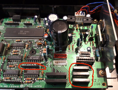

I got the printer head from Dave, so have attempted to repair the printer. I also ordered 3 replacement TK3L10Z transistor packs as they seem to be what drives the print head pin solenoids.
Certainly one of them (the top one of the 3 circled in red) had very different basic resistance measurements over 3 different pins compared to the same pins on the other 2 and the 3 new ones, so I suppose that's a good sign it was a dud (measured out of circuit).
Up-stream from that transistor pack is the 4.7k resistor pack, also circled. That seemed fine. Up-stream from the resistor pack is the large controller chip. But as I feel reasonably confident that the transistor pack 3 is likely to have been bad, I'm not going to the trouble of replacing that oddly spaced unsocketed monster... looks like it's a 2.5mm pitch?
Anyway, I just need to set up the printer near to the main QL and I'll give it a go.

No, unfortunately it is still faulty. Pins 1, 3 and 4 are not firing. I get the same readings: 6 are around 33 ohms and 3 are open, so that would correspond with the 6 working pins. But if it worked for you, then that would still suggest my PCB has an issue I suppose.Dave wrote:Three show open, one shows 1.8M, all the rest show 33. Working pull I did a test print on right before taking that pic.
But at least it's all together again and I haven't made it any worse.
