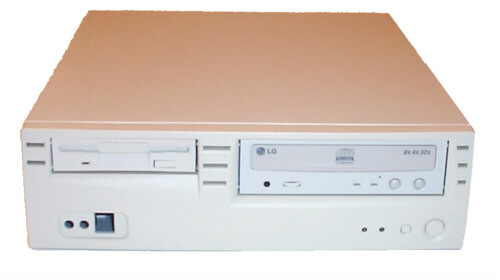

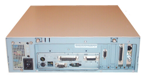

I have my main Q60 in this slim MiniATX case:
As one can see, I had to shorten ethernet and I/O card brackets because of the lower height. Not bad, but still much larger than would be possible.

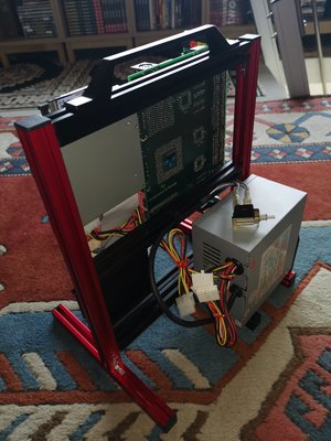

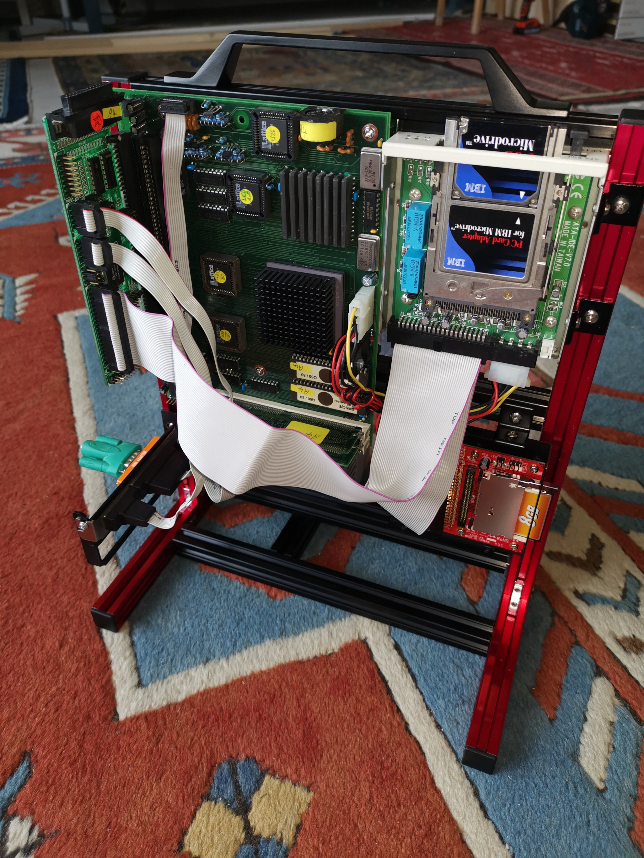

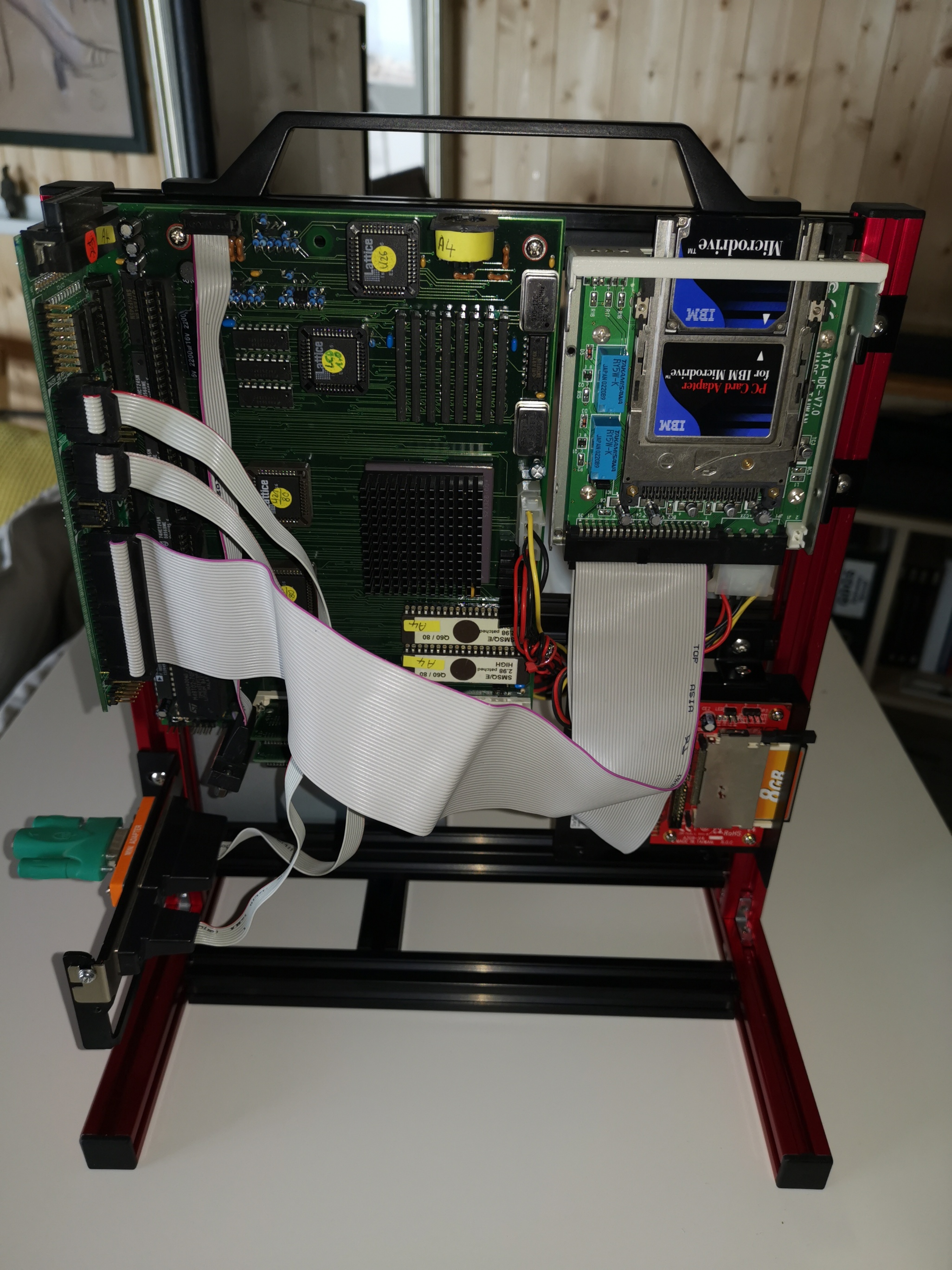

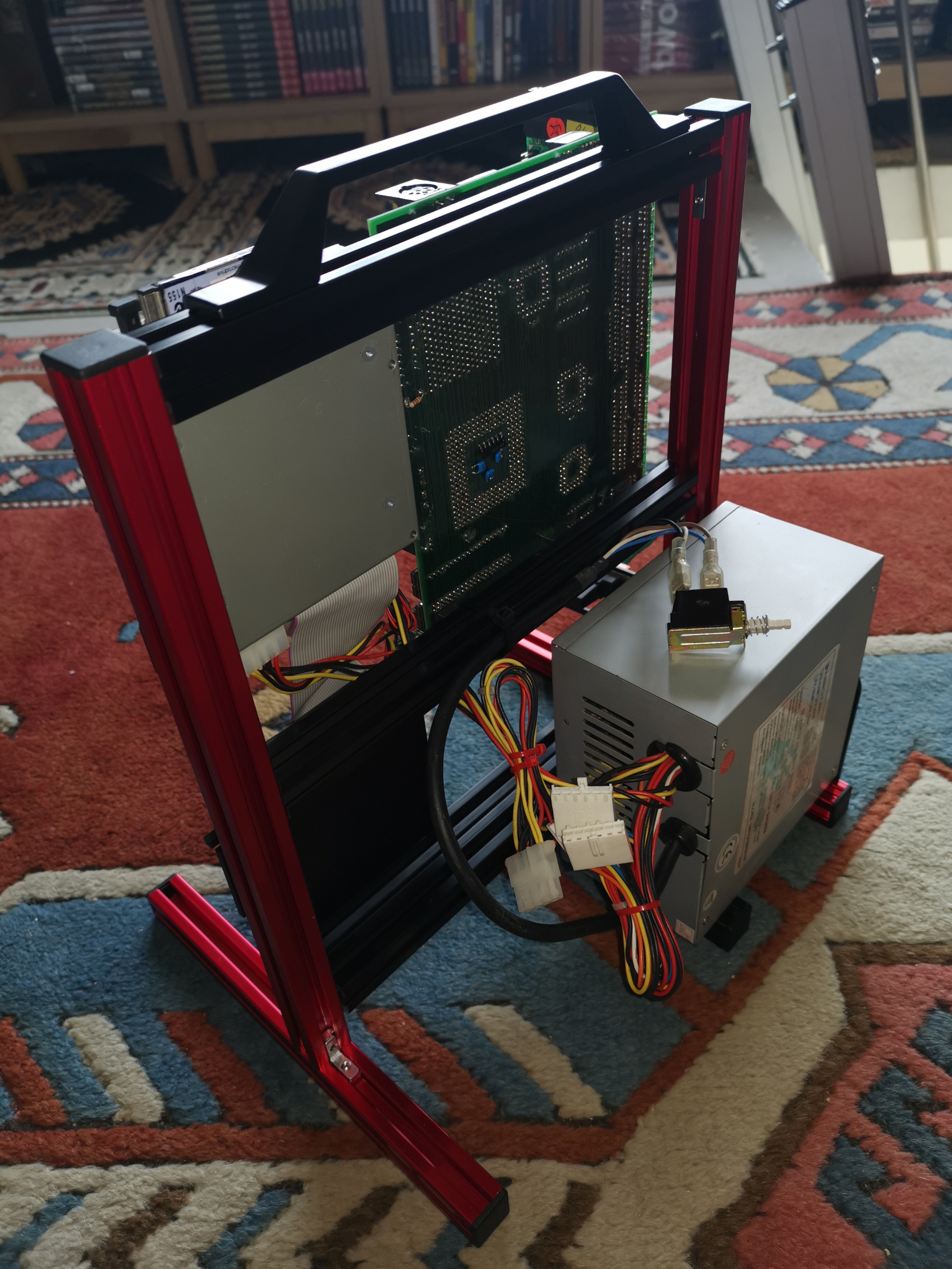

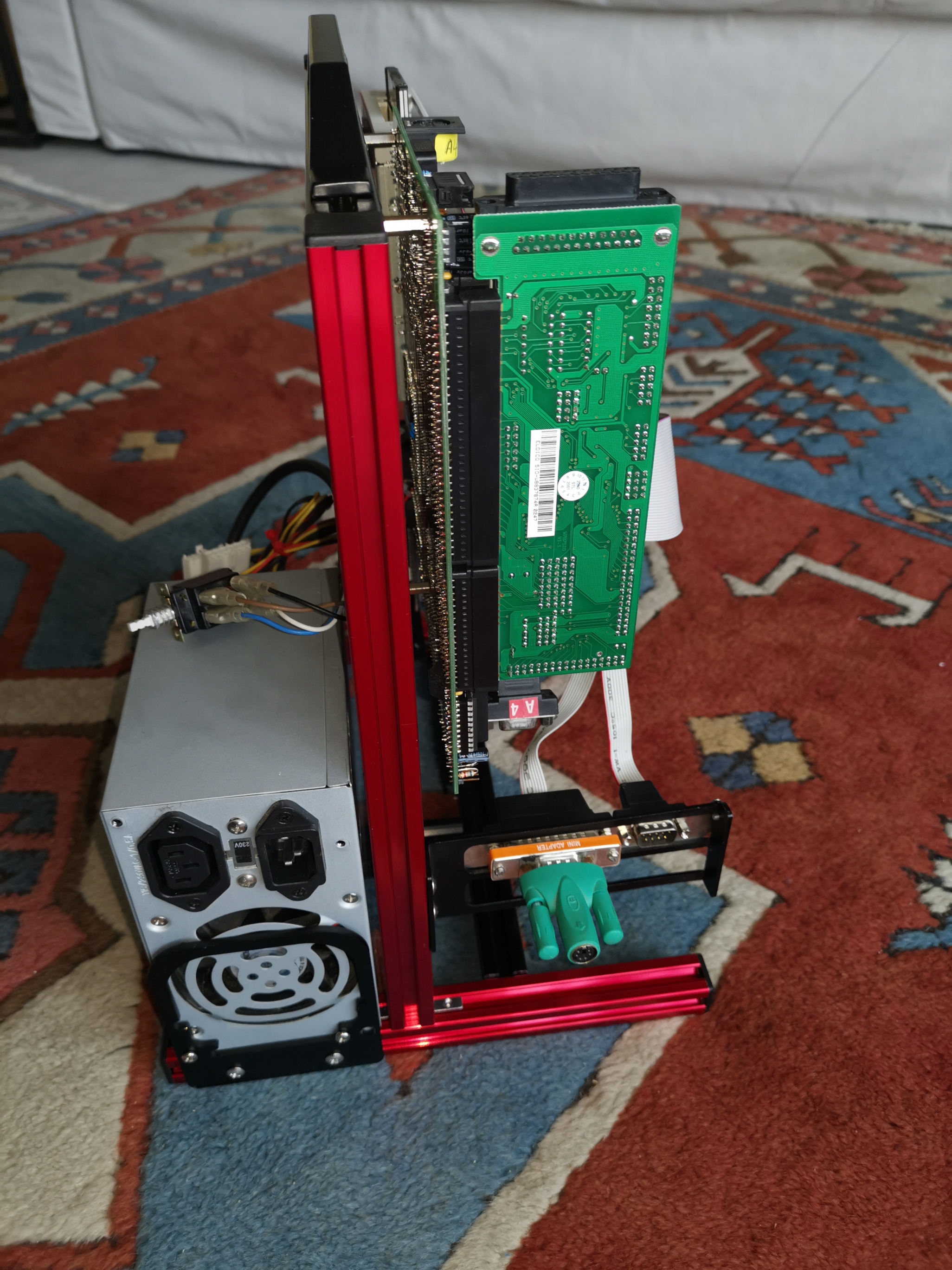

Since a long time I was also looking for an alternative solution for my Q60 case, even because I use a riser card on the second slot so to have 2 ISA I/O cards and the ethernet. Unfortunately I was never able to find an easy and net solution to host what I need without deep modification of the case.
Until I end up in such case that you can see below, well it is not a case but more a framework, it is advertised as overclocking PC solution but is really a DIY tools able to host any motherboard size and devices.
Something that i liked immediately.
So far, as you can see from the pictures, I did not install the riser card and the ethernet (Peter I will pleased to try your ethernet driver :) ) and I removed floppy also (not anymore necessary)
Two IDE Compact flash IDE devices, the first it is used with an 1 GB IBM Micro drive ;) :( just because it is the smallest CF that i have around needed to load latest SMSQ/E version and then with the command WIN_DRIVE 1,1,0,0,'QLWA.WIN' I replace win1 with the 8GB Compact flash.
Not yet replaced the Power supply with a modular ATX unit.
Work in progress.....
Fabrizio
Posts: 1184
Re: Does ITX Cases work for any QL Compatible Motherboard
Ah, seems to be the only Q60 working with a genuine Microdrive :D
Posts: 4720
Back in 2003, I did mention on the QL-USERS list about IBM Microdrives would make a Q60 compatiable with the QL... But it got lost in conspiracy against the production of the Q60 by persons unknown.
I am glad to to see the Q60 is still running, you will note the 'A4' stuck all over the board, which means the Q60 board was the 4th board of batch 'A', or the 4th Q60 made.
I see the LCD Chip installed, any chance of some screen shots of the Q60 running?

Posts: 2435
I still see the original EPROM version installed. Just want to mention that Wolfgang created a self-decompressing version of recent SMSQ/E that again fits into these chips, so one does not need to boot twice anymore. If you have someone with suitable EPROM eraser/programmer of course.
