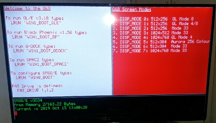

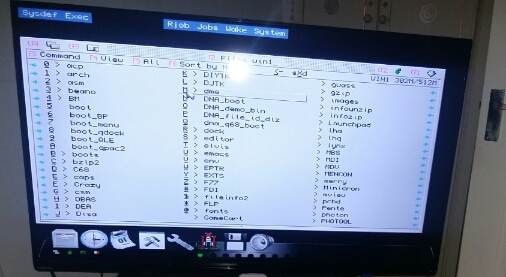

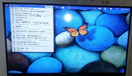

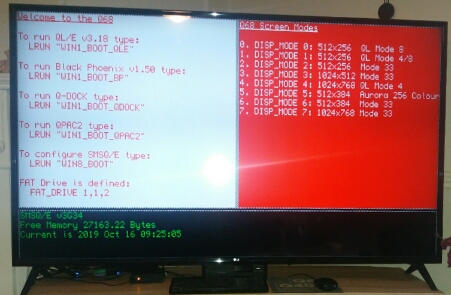

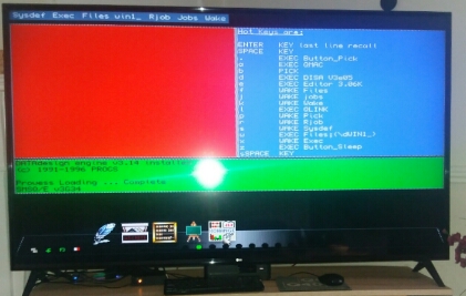

I tried a Q68 on a Toshiba50L2436D, 50" TV, plugged directly into the VGA Connector, where some badly taken photographs: I prefer DISP_MODE 4: 1024×768 4 colours, but DISP_MODE 6: 512x384 Hi Colour is quite nice as well.
I had a look at the service manual for the Sony KDL-26S5500, but there was no real information on the VGA output. Except for the ouput was 1360x768 @ 60 Mhz, which the Q68 should handle.

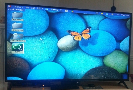

I connected a Q68 to a LG65UK6300PLB TV, (65" screen size) into the HDMI port with a VGA to HDMI converter.
I switched the aspect ratio to 16:9.
Works really well.
