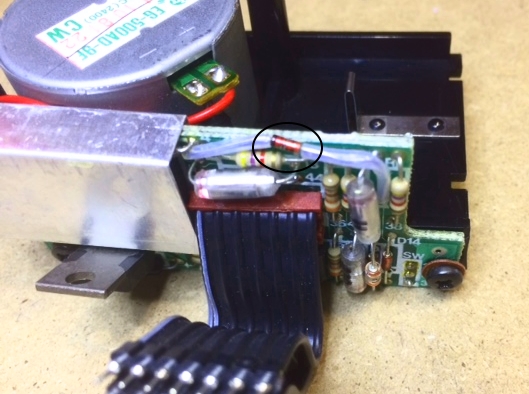

Re: MDV1 and MDV2
The units are identical - they are interchangeable. Check if the diode was installed on both of them . Without that diode (on both of them) vDrive will not work

Re: MDV1 and MDV2
Thanks Andrew.
What diode to use and where does it get connected on the drive?

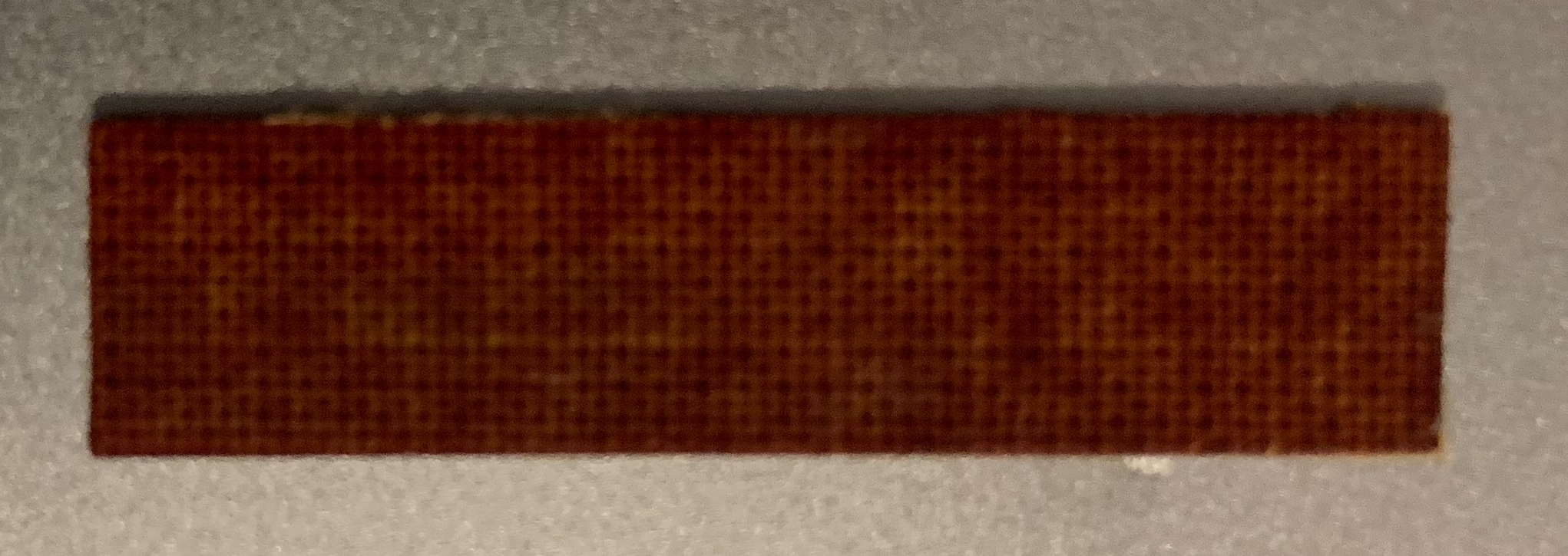

Re: MDV1 and MDV2
Why is the shield needed? And what happens if it's missing?Cristian wrote:Be careful! Mdv1 must have an additional metallic shielding!
3 of my QLs came without the shield

Re: MDV1 and MDV2
My drives have the diode. I installed the new Map and installed new MDV1 and MDV2 and everything is working. So now I have a brand new QL!

Re: MDV1 and MDV2
I thought it was a heatsink to stop it being affected by the small chip on the motherboard right against this shield?Derek_Stewart wrote:Hi,
It is an RF Shield.

Re: MDV1 and MDV2
No, could't be a heatsink, as it had some isolation on the insideRWAP wrote:I thought it was a heatsink to stop it being affected by the small chip on the motherboard right against this shield?Derek_Stewart wrote:Hi,
It is an RF Shield.

Re: MDV1 and MDV2
Definitely RF shield as there is a piece of shielding material that sits behind that metal cover. This material is what cancels the RF, the metal shield is to keep the material in place and to keep from touching the Motorola 1377
