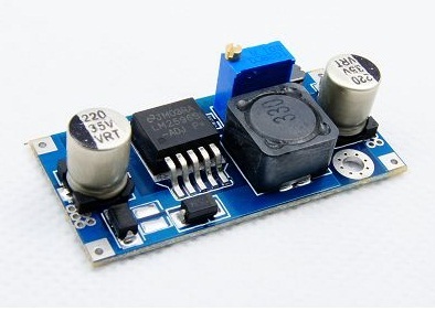

update !! , i have ordered this one ( see picture ) and hope it will do .
