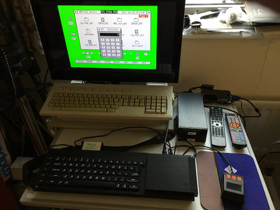

I know it's unlikely but can the Pointer Environment use the mouse connected to the Eidersoft M-ice dongle?
It would be dead handy if it did, given that's what I have.

Yes, (M)ICE first appeared in 85 according to the copyright and was the first WIMP interface. I seem to remember the other systems turned up some years later.
The interface is very rudumentary. There's no scrolling and no double-clicking, merely using different buttons. There are no windows as such either. Other than ARTice, I can't remember anything using the system and it's little more than a file manager otherwise.
