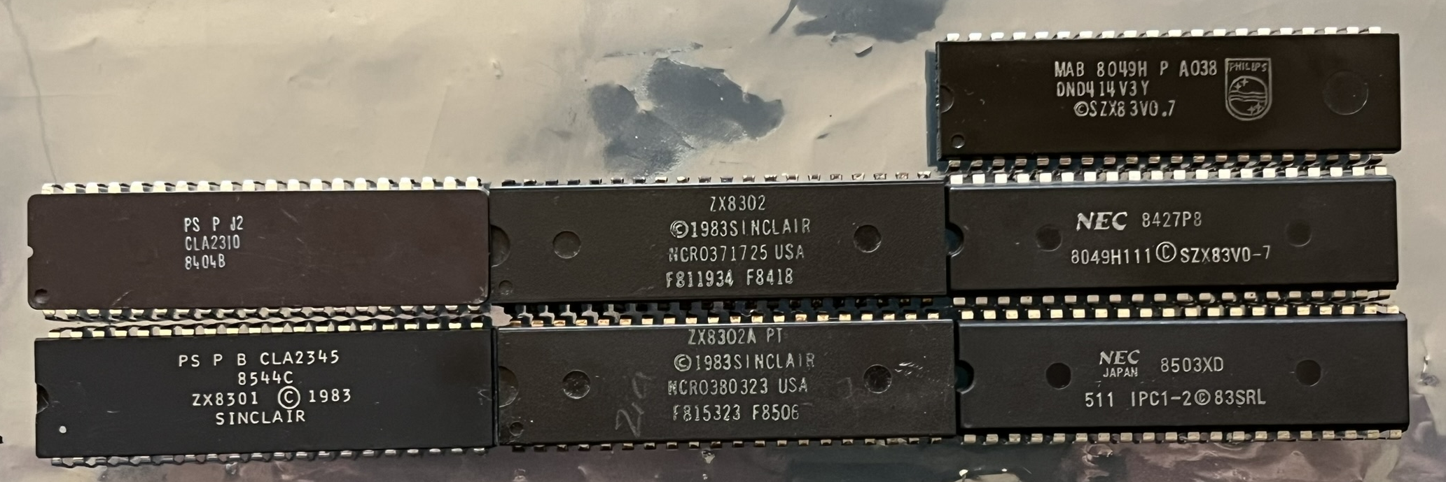

Updates regarding the Sinclair QL chipset: There is a 2nd version of the ZX8302 Peripheral Chip called ZX8302A with ID NCR0380323! For details see: https://sinclairql.net/build_standards.html
