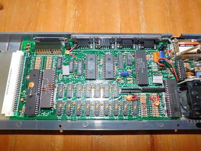

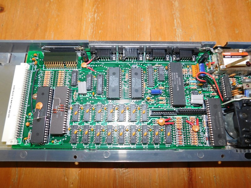

In a QL, they are in a case that is cooler inside compared to a rubber key ZX Spectrum 16k/48k. The ZX Spectrum+ is not as bad but still rather warm.
The electrolytic capacitors in the DC/DC converter section of the ZX Spectrum are worked hard and operate in a hot environment. The loss of the -5V supply generated by this DC/DC converter means that the 4116 DRAM chips loose their bias supply. They don't like this, and can die as a result... Hence it's best to replace them before failure
In a QL, with it's design of power supply, the electrolytic capacitors get an easier life (they therefore last longer). Plus, it's safe to run the machine until failure.
