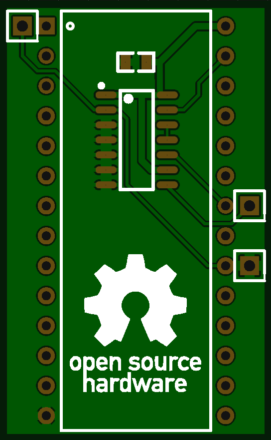

I have space in another board I'm sending out for manufacture to slip in this little beastie.
Like most of my work, it will be an open source design.
My internal debate is, do I just want to do a basic carrier for Minerva, or should I go the trivial extra to add a battery backed clock option? Adding that also allows so no pins need to be bent on the EPROM.
What do you think?

Dave wrote:I have space in another board I'm sending out for manufacture to slip in this little beastie.
What do you think?
Wow ;)

It looks like the economics of it mean there won't be a clock option. I'm comfortable with that because there will be something else with Minerva and a battery backed clock in the next few months. It's much cheaper to incorporate it into something else than to to it as a standalone board. Meanwhile, I am still waiting on the turned pins to arrive so I can correctly size the holes.
I'll sell the boards with the SMD component mounted, but the pins will need hand soldering - that way it can be shipped as first class mail instead of parcel mail. That cuts shipping costs by 80%+. If people order it with something else that is going parcel mail anyway, I'll mount the pins for them.
