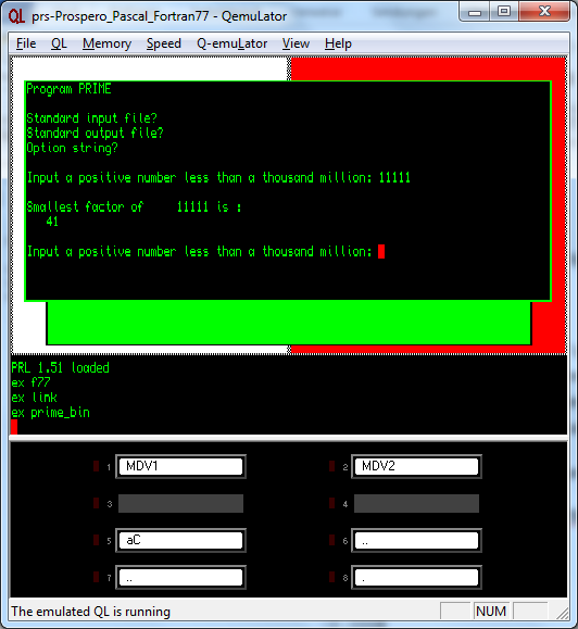

I have been able to compile programs with the Prospero ProFortran compiler. I found that you don't need to load both the Eprom and the resident toolkit (in fact if you have both loaded, the compiler will not work).
The problem that I am having is with executing the resultant binaries. I've compile the PRIME and SQUARES example programs, but when I execute them, nothing happens. Through the Jobs command I can see a new job has started, but the screen has not changed.

All runs fine here.
Without going into details, try the thingy out of THE DISTRIBUTION where everything has been pre-configured and tested. The Prospero suite is in the folder \xcl\prs\, the pre-configured QemuLator in the folder \xcl\. Just start QemuLator with the supplied prs-Prospero_Pascal_Fortran77.QCF configuration file.
Once started, here’s the path to success:
In SuperBASIC
PRL
EX F77
Then in the compiler
MDV1_PRIME
. (to take defaults)
Once the compiler has finished his job back in SuperBASIC
EX LINK
In the linker
MDV1_PRIME MDV1_F77
Once the linker has finished his job back in SuperBASIC
EX PRIME_BIN
All fine here.
Never underestimate the power of THE DISTRIBUTION.
QL forever!
Urs
