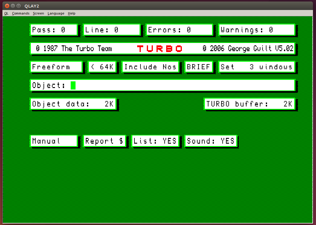

I used QLAY2 see attached screen shot.
Just LRESPRed Turbo_TK_Code and was in the Turbo subdirectory, entered Charge...
You must have a corrupted Turbo Distro.
You could try, entering:
EXEC parser_task
This will load the Turbo Parser
And when Parsing done, enter: EXEC codegen_task
Will generate the executable compliled programme.
Why not use QPC2...
Turbo Under QLAY2 (Linux/Wine)
