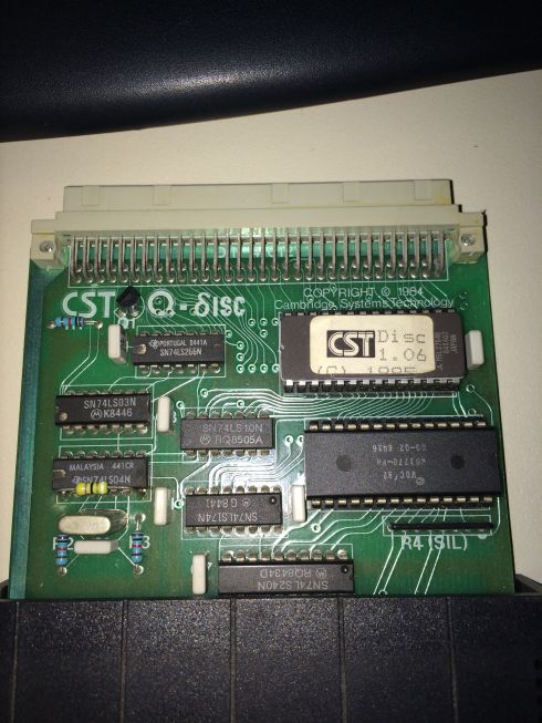

Thanks everybody for your suggestions. Doesn´t sound very promising for the early version of the interface then. Mine says "Q1", just below the top transistor.
Still I will try with a new WD1770 first, once it arrives.

Q1 is the pcb(and schematics) letter code for this transostor. Q1 is like the R2 and R3 codes for the two resistors near the xtal(crystal oscillator). :)

Ah, did not realize that.Thanks!
Could not spot any other hint on what version the board is.

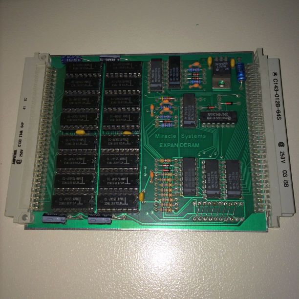

Success with the Expanderam! I ordered a bunch of memory chips from China and replaced first half of the chips on the board. Either it was the wrong half or more than one chip was broken, but when I replaced the second half in addition, the white screen was gone and the PEEK_L command for installed RAM showed 640KB :D
With sixteen new RAM chips: To the next 30 years!
