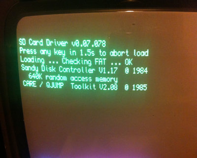

I've fitted the new Sinclair QL-SD card that I bought from SellMyRetro from the Seller Paulveltjens.

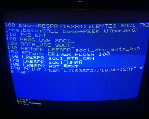

However I wish to edit the SD card image called QL_BDI.BIN. In the manual it states that you can create/edit these BIN images using a tool called 'MakeImage.exe' on the PC. But does not state where this tool can be downloaded from, and I've tried various Google searches with no joy :(
On top of that, I'm struggling to create sub-directories on the SDC1 card:-

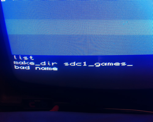

Tried the normal command 'MAKE_DIR SDC1_GAMES_'. But all I keep getting is BAD NAME. I have tried contacting Paul via SellMyRetro, no reply as yet. Any help you chaps can offer me will be appreciated :D

Seems to be easy: Neither the firmware on your Sandy disk I/F nor the Toolkit 2 in these versions support the Level 2 device drivers. You have to make an upgrade.

And...no chance to fool your System by taking a TK2, which inhibits the Level 2 keywords. This does not work, if the Level 2 driver ain't there, you always get an ERR.BP after a "MAKE_DIR", even if it recognizes the keyword. I know, because I have tried that long ago... :D

the QL-SD driver actually is a level 2 device driver implementing every necessary function (on trap level). So using TK2 with a MAKE_DIR command will work.
What's missing is (to save ROM space, because most of the Toolkits already come with MAKE_DIR) the S*Basic extension supplying the MAKE_DIR command.
If your set-up doesn't provide a MAKE_DIR command, it can be implemented using the attached extension (simply unzip and LRESPR from your BOOT file and Bob's your uncle)
make_dir.zip
(421 Bytes) Downloaded 158 times
This seems to be missing from some SD-Card images for some reason.
