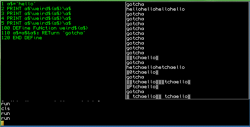

I just tried it on QPC2 (smsq/e v3.08) - that demonstrates a different result:
hellohello
gotcha
hellohello
but the second print line gives:
gotcha
gotcha
hellohellohellohello
Even worse is if I add 4 print lines and then run the program a couple of times - see the attached screenshot:
So this could explain the oddities experienced
