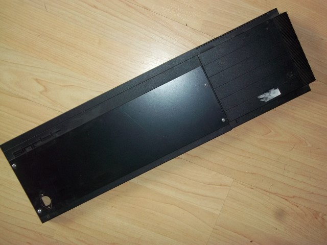

I have a QL case top here with a blanking plate instead of the keys, and a cut out for you to pass a keyboard connector through - eg. for a jurgen falkenburg keyboard adaptor inside the QL.
If anyone wants it (it is heavy as the blanking plate is metal) then you can have it for the cost of postage.
The case top itself is not much use without the blanking plate, as you will have 4 screw-holes where the blanking plate was attached.

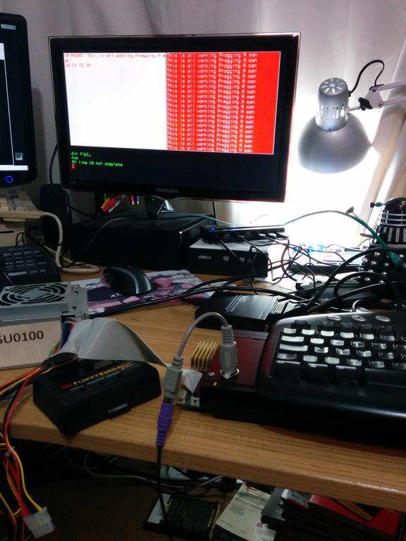

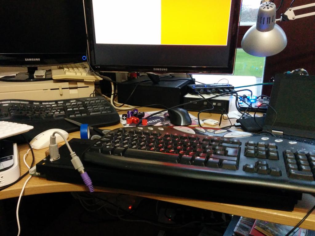

Well I have assembled machine, now just to work out how to get driver on boot

Well with some googling (to find QDOS commands) HxC software, a little help creating images from Q-Emulator its all working.
Drivers loaded from flp1_boot off HxC hfe image.
Really happy now
Really happy now
