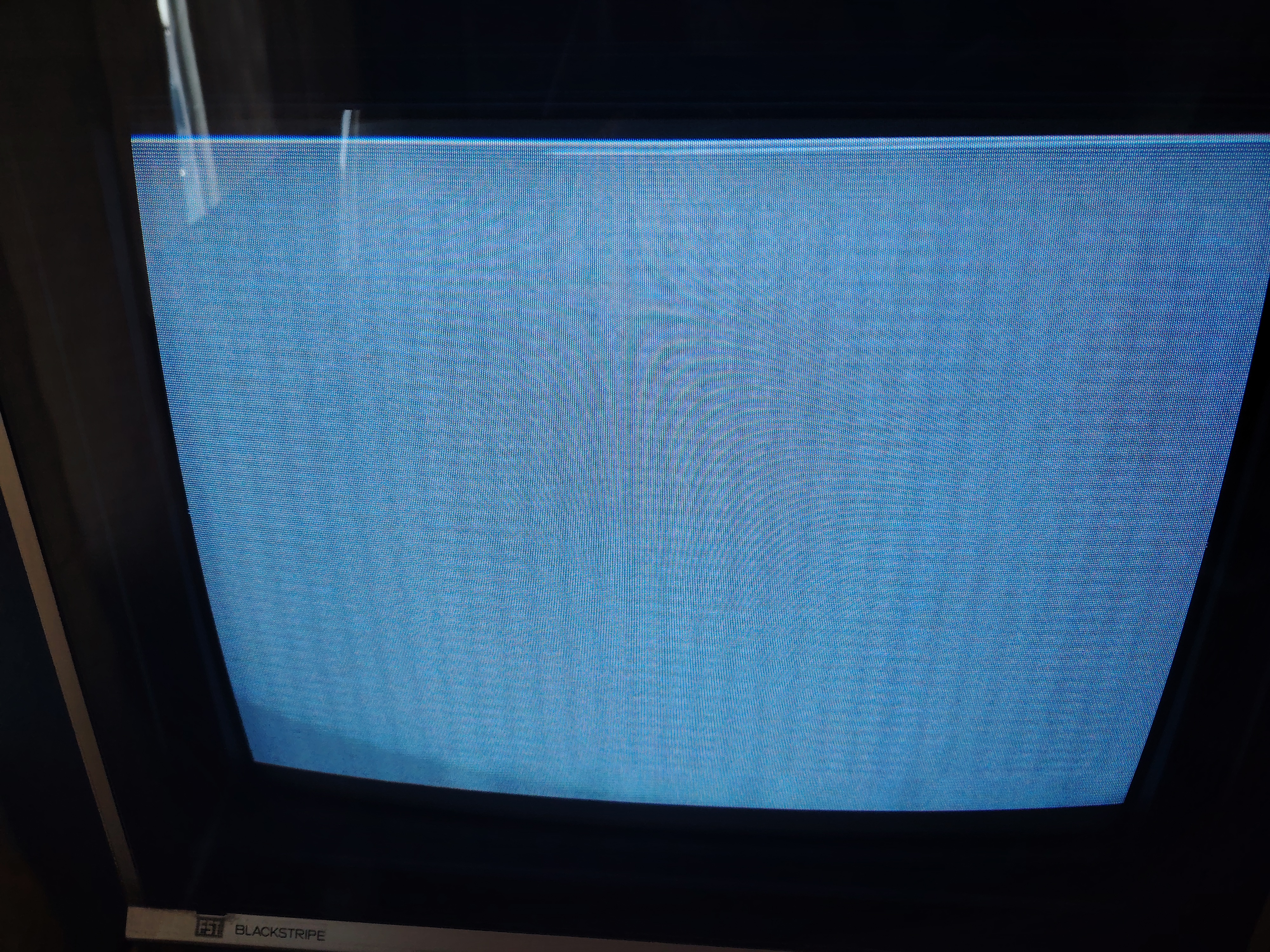

When plugged in it's just a black screen. But if you press the reset it sometimes shows this screen. I have purchased a minerva rom hopeing the ram test would pick out faulty ram chips but it fails to boot with the minerva rom as well.

The second image shows a display, so the video output is fine.Derek_Stewart wrote: Wed Jul 09, 2025 7:01 am Hi,
The above is all good advice, but lack of display, in most cases is a faulty 8301
I would check the operation of CPU, 8301, 8302, 8049.
It's probably a lower memory bank memory error, which is bad enough that Minerva can't start up.

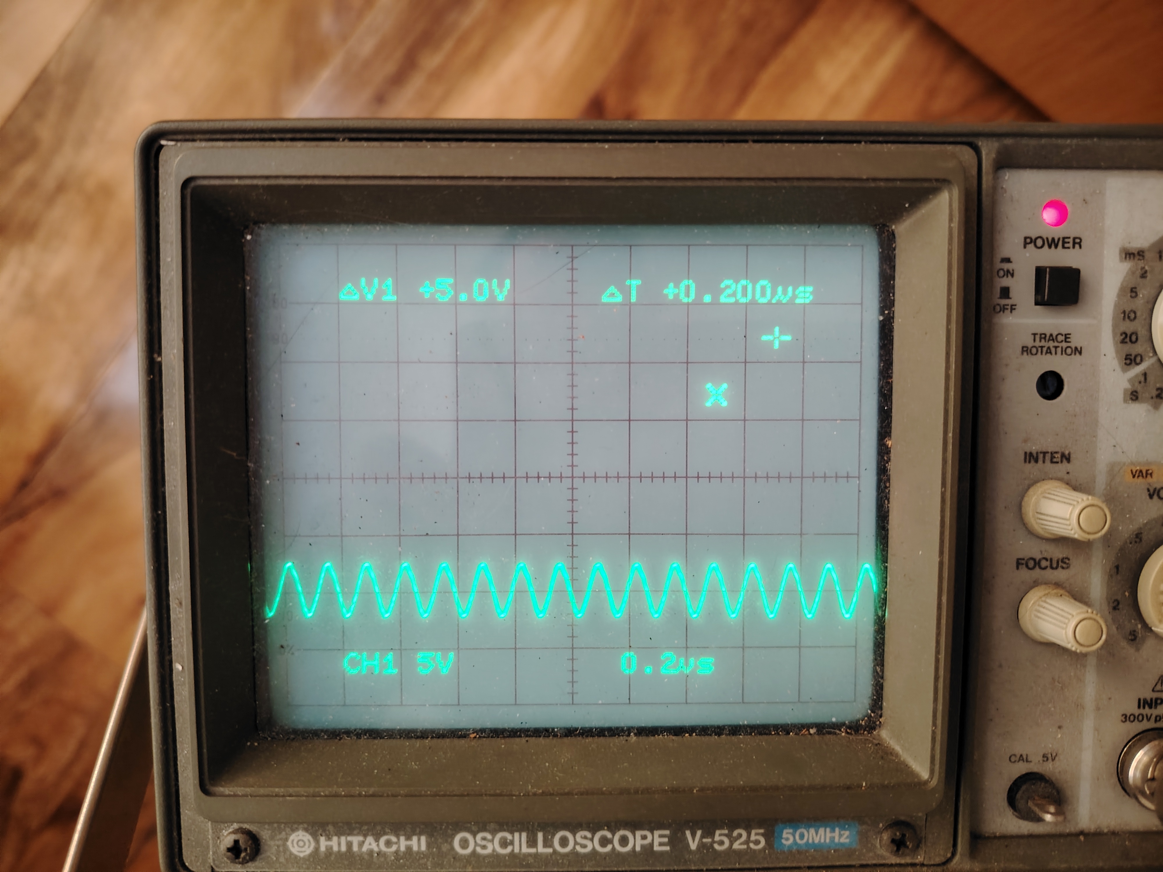

Tested the cpu the voltage is 4.91v the clock signal is showing this. With the reset it is showing this.

Beautiful oscilloscope, I love it.Traindriver69 wrote: Thu Jul 10, 2025 10:19 am Hi
Tested the cpu the voltage is 4.91v the clock signal is showing this. IMG_20250710_100416_edit_41840307230913.jpg
https://youtube.com/shorts/ag-cjybbV9M? ... 4JgIvzISPY
So the main rail of +5v is working fine & not shorts between +5v and GND.
Next... use the same oscilloscope and check each addrs line related with Memory and also Data out of each RAM IC.
