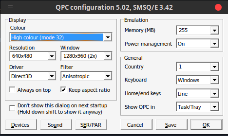

Try setting the resolution to 640x480, and the window to 1280x960 (2x). This will give you reasonably sized characters (if don't mind very small characters, you can try 1280x1024 with 1x magnification).

You need to alter the Window size in the QPC2 startup screen:
Hold SHIFT when load QPC2 executable if this screen does not appear.
Set the physical window size in the WINDOW section, and the QL resolution in the RESOLUTION section

Thanks both, worked a treat. The actual values seem to behave oddly. 640x480 gives a much larger "QL" display, 800x600 much smaller. Never mind, 640x480 is perfect size!
