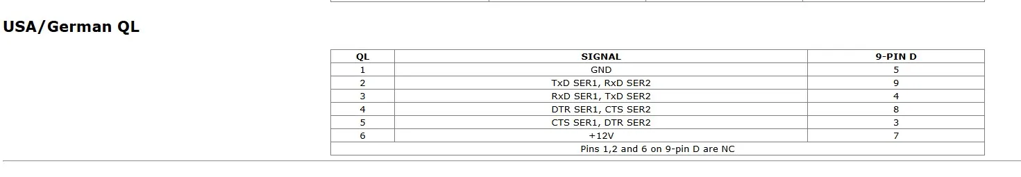

Hi to all guys at QL FORUIM :-)
I've found this scheme for made a Serial Cable for connect my German QL on the WIFI Modem Hayes that have a DB9 fermale serial port.
In the scheme attached in the right part there are the connection by "QL side" but Is not attended If are of the Female QL port (QL SIDE) of are intended for the Male port (cable side).
For the Germal QL is need a female to female serial cable for connect a modern Wifi Modem (that is seen as a PC and not as a real Hayes modem too).
In practice I need to know If in the scheme is intended as FEMALE or MALE serial pins on the QL side.
I copy the link of the schemes:
https://dilwyn.theqlforum.com/gen/serial/serial.html
Thanks a lot.

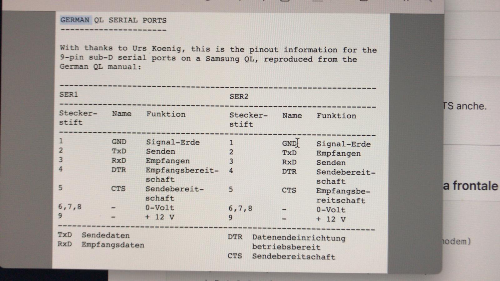

We have found also this scheme of URS about the GERMAL QL ports (attached).
We will try as suggested on #QLFORUM Discord/IRC chat:
"pinout on Dilwyn's site is wrong for them the trick is that UK pins 1-5 = German/US pins 1-5, UK pin 6 = German/US pin 9"
and yours help too.
