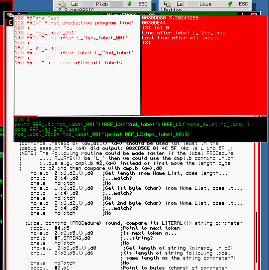

To improve this further, I need a method (ideally in SuperBASIC without the need for a machine code extension) to get the highest line no. of the currently loaded SuperBASIC program. I could not find anything, not even in Jan Jones QL SuperBASIC The Definitve Handbook. Any hints?
I have now written a machine code library (toolkit) with 2 FuNctions which return the first line number and the first "free" (unused) line number (last line + 1) in a loaded S(uper)BASIC program (works also in MultiBASICs on Minerva, QPC2 not yet tested). Tested on Minverva on sQLux and QPC2 (multiBasic not yet tested, 0,0 okay).
