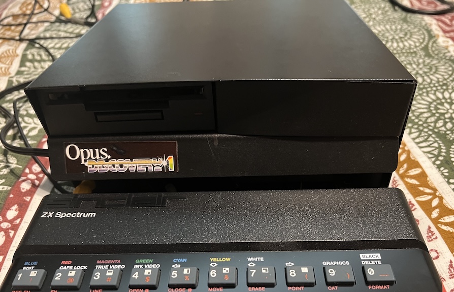

I've picked up a non-working Opus Discovery 1 for one of my ZX Spectrums
Once I can get it working the plan is to install a 6116 & New ROM & a spare GoTek as the main drive
Currently, I haven't opened it up yet, I can hear the fan running (at least I hope it's a fan!) but get no output from the ZX but do get a garbled output from the composite out on the back of the Opus
Was wondering if anyone has experience of these and could give me any tips on what to look at/test please?

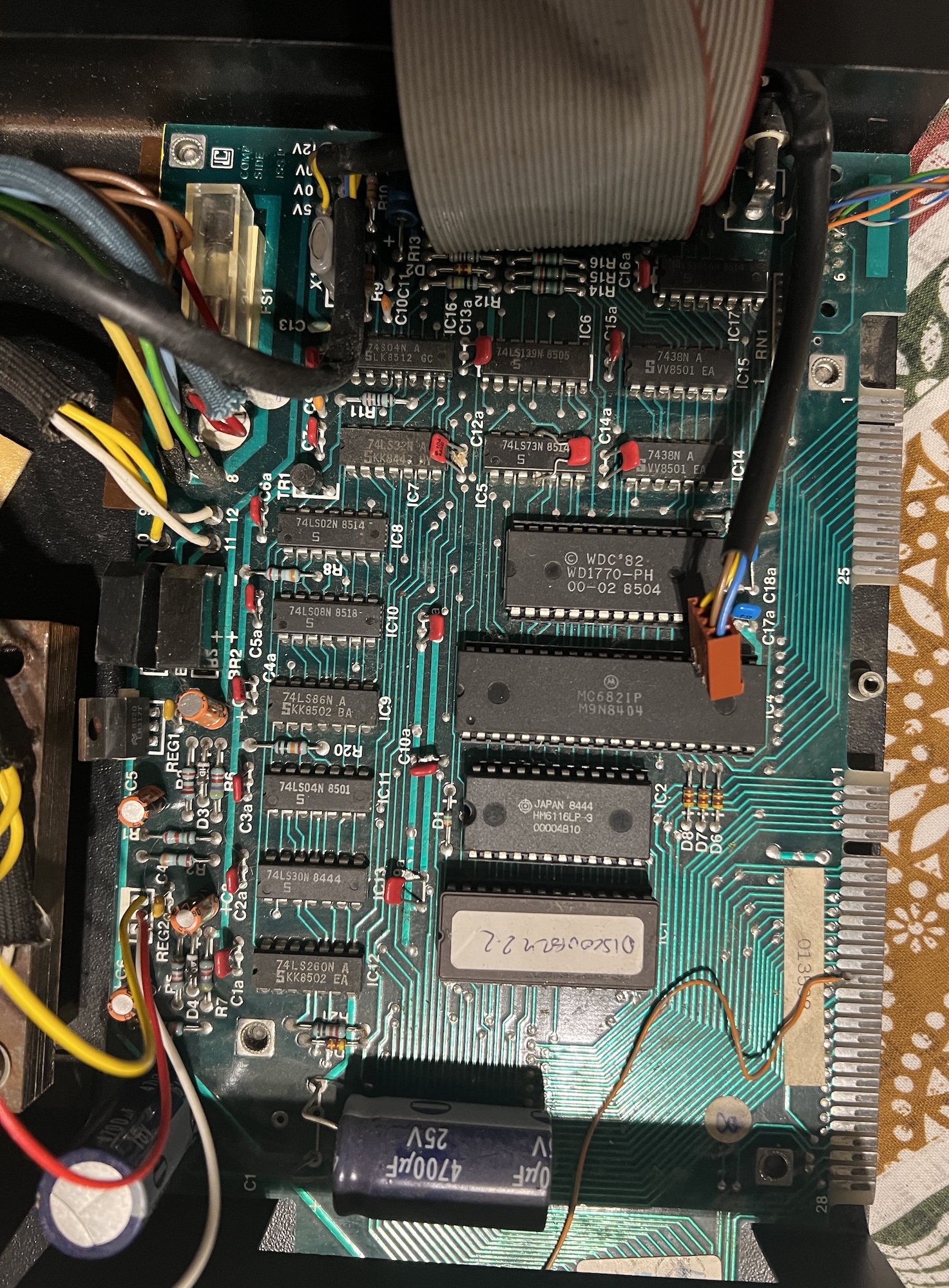

Have taken it apart now. No fan, the noise was from the floppy drive
Will try to find out what power the transformer is mean't to put out and check that first
Will then try re-seating (with a clean of the sockets) the socketed ICs & also try replacing the 40 pin IC

I wondered why I had 3 loose wires
When I took the case apart I ripped the regulator off!
I’ll have to fix that before I can test the power rails
Luckily one of the heat shrink sleeves stayed attached to the regulator so at least I know which way around to re-attach it
