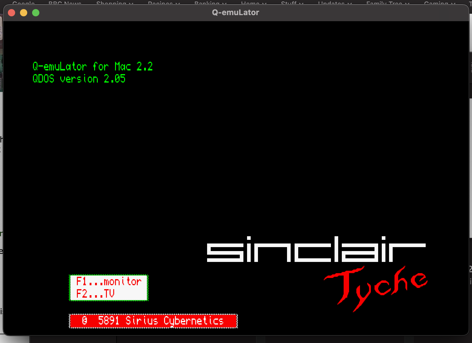

I've just had a quick play with the Tyche ROM in Q-emuLator, looks interesting
But given that I would assume it was a sequel to the JS ROM I don't follow why "WHEN ERRor" doesn't work (seems like it's based on JM ROM? or they just dropped the command/function for some reason?)
Was wondering what others experience of it is please?

That ©5891 number, when reversed, gives the year 1985. The real year of release, I suppose. What a strange ROM

Cristian wrote: Tue Feb 25, 2025 7:00 pm That ©5891 number, when reversed, gives the year 1985. The real year of release, I suppose. What a strange ROM
I didn’t spot 5891=1985, maybe I’ve put the ROM in back to front… :D
