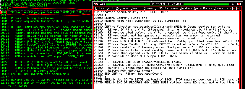

Thank you for testing Derek. I have now tested it again on QPC2 and now it runs also in a MultBASIC Window, seems something in the former QPC-session has been corrupted. But when I try to load it in Minerva on uQLx all lines which contain err% are marked with MISTake :-( I have printed EXTRAS to a file and have had searched for ERR%, but such a SuperBASIC command does not exist. Strange. Following show a stripped down version with the MISTake in TKII-Editor and on the right the program in MicroEMACS.
Here the program source:
100 err%=hps_openOver(#4,'RAM1_DELETE_ME')
19990 :
20000 REMark Library functions
20010 REMark Required: SuperToolkit II, TurboToolkit
20040 :
20080 DEFine FuNction hps_openOver%(c%,fnam$):REMark Opens device for writing
20090   REMark If it's a file (filename) which already exists it will first be
20100   REMark deleted before the file is opened new (with fop_new(). If the file
20110   REMark could not be opened for read/write, an error is returned
20120   REMark The arguments (parameters) are not altered by the function
20130   REMark W A R N I N G : fnam$ must be a fully qualified name (no default from
20140   REMark SuperToolkit II, e.g. DATAD$ is added before fnam$)! If not a fully
20150   REMark qualified filename, error "bad parameter" (-15) is returned.
20160   REMark Note: File is not really opened with FOP_OVER but it's deleted and
20170   REMark then opened with FOP_NEW(). This means it also will work on UQLX
20180   REMark which does NOT support OPEN_OVER
20190 :
20220   IF DEVICE_STATUS(0,fnam$)>=0:DELETE fnam$
20260   IF DEVICE_STATUS(1,DATAD$&fnam$)>=0:RETurn -15:REMark A fully qualified
20300   REMark filename must be passed to this function!
20340   RETurn FOP_NEW(#c%,fnam$)
20380 END DEFine :REMark hps_openOver()
32757 :
32758 REMark Use GO TO 32759 instead of STOP. STOP may not work on all ROM versions!)
32759 REMark END OF PROGRAM (NO LINES MUST follow, some ROMs may not allow line numbers >= 32760!
