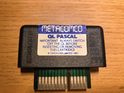

HI, I am a happy owner - well, used to be a happy one - of the QL Pascal Development Kit by Metacomco.
When I tested it a couple of years ago, the external ROM used to work fine. However, now upon running the Pascal programme the QL show the message "ROM not included or wrong version".
Is seems the external ROM is corrupt - is it possible to fix it?
I attach pictures should they show anyting particular.
Thanks!

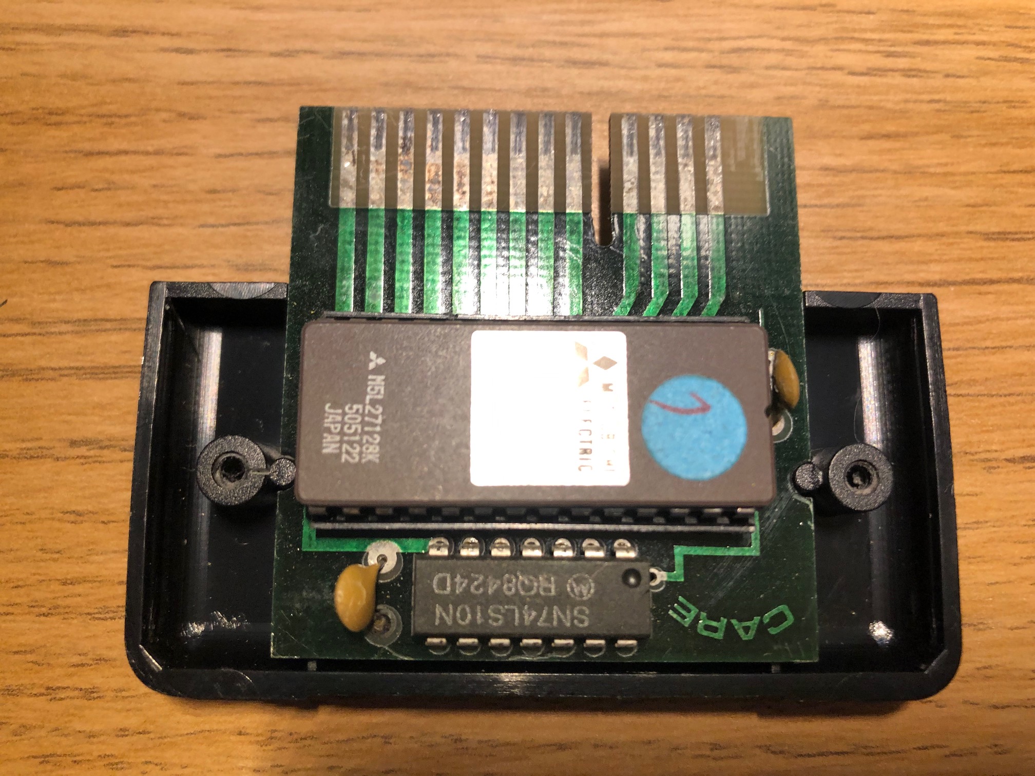

The photo makes it look like the contacts are corroded.have you tried cleaning them with one of those cleaning brushes made, I believe, from fibregalss?
If I remember correctly, the contacts have a thin layer of solder over the copper, it dulls with age and resistance goes up as it oxidises. Maybe a rub down with IPA (Iso Propyl Alcohol) would also help?
Failing that, is the chip socketed? If so, the legs might need cleaning. Stab them onto a sheet of tin foil a few times.
HTH

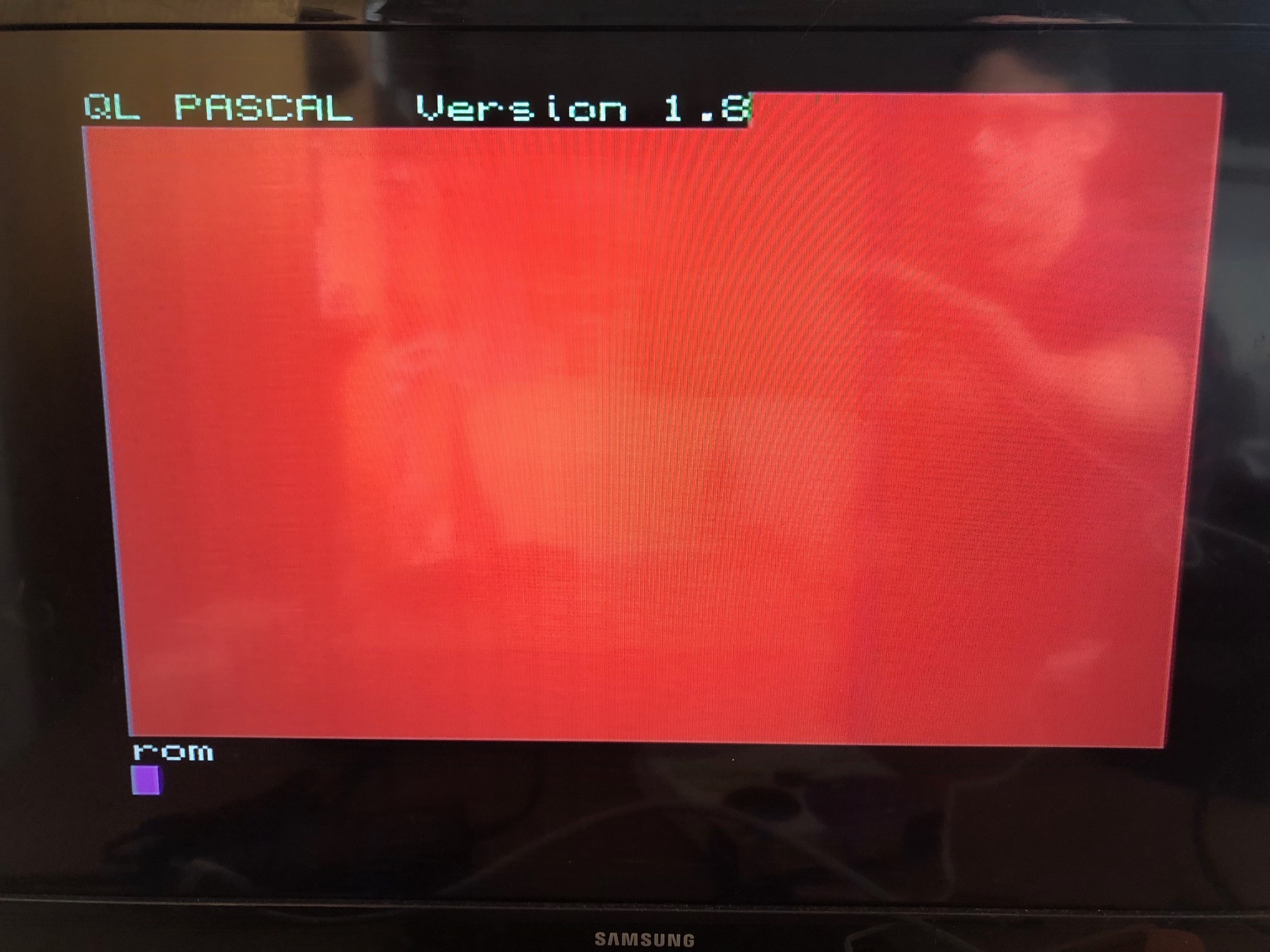

None of the Metacomco Pascal ROM's I have display anything on the F1/F2 screen, you have to issue the "ROM" command after pressing F1/F2 and it then displays the ROM name & version on the screen in a small 1 line boxDerek_Stewart wrote: Tue Feb 11, 2025 7:45 pm Hi,

Re: Non-functioning Pascal ext ROM
The ROM command is something Metacomco supplied to verify the Eprom cartridges. If it is a valid Eprom as far as the contents are concerned, it displays the Eprom name and version. If not, it displays "Bad ROM".
It isn't a command to activate the ROM itself.
Thanks for the clarification Norm, I can stop bothering with typing it in then
(They still don’t display anything on the F1/F2 screen though)

Thank you all for your feedback.
@NormanDunbar: I tried cleaning it with IPA, I also used the tin foil for the chip, but no result. Will try to clean it with a fiberglass brush I ordered.
@t0nyt: the ROM command doesn't work, it says "bad name", so it might be that the ROM is not detected at all.
@dilywin and Derek_Stuart: I have only the vDrive installed, nothing else. I tried it with JS and Minerva ROMs.
Thanks, dilywin for the ROM, - the next step is to try it with the emulator.
