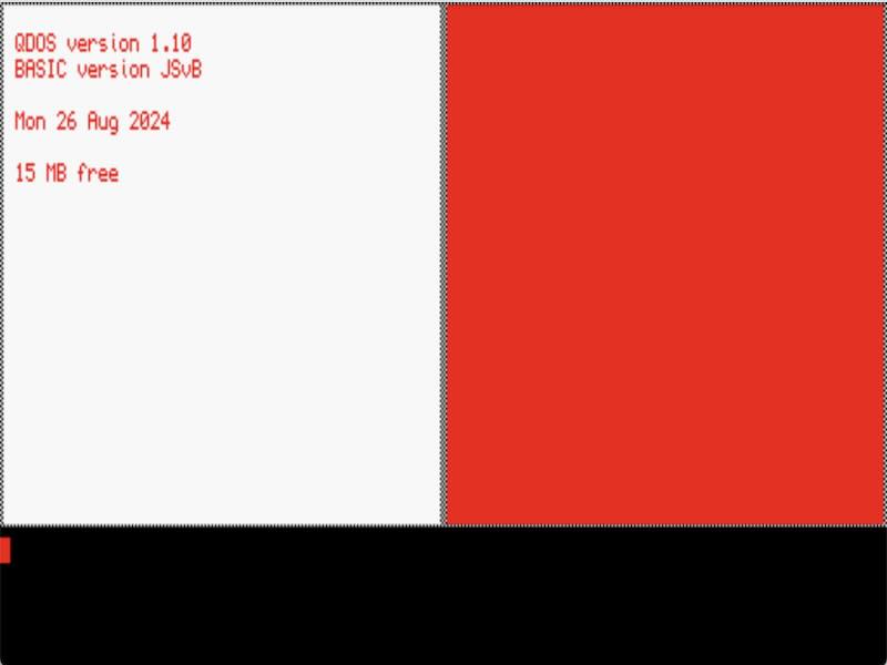

While working on QDOSClassic there were a few fixes discovered, so I thought it was about time I brought them over to the origianl JS ROM. These are mainly patches for large memory systems, but it also includes an improved Floating point output accuracy routine by Simon Goodwin.
The patcher is attached here as SuperBASIC program. It requires an original JS ROM file and outputs a patched ROM called "JSvB".
The resultant "JSvB" ROM has been tested on Qlay2 and QL2K with up to 8M memory, and on sqlay3 with "ramsize = 16000" .
There doesn't appear to be an option on sqlay3 to set the speed to be anything other than BBQL speed, so it currently takes 4 minutes 23 seconds to initialise the nearly 16M of RAM.

What I should have said is that on sqlay3 if I set the RAMTOP to be $FC0400 with "ramsize = 16001", then the ROM appears to crash with a white screen during the memory test routine. Debugging with F12 shows no crash. Simply that the screen went white during the memory test.

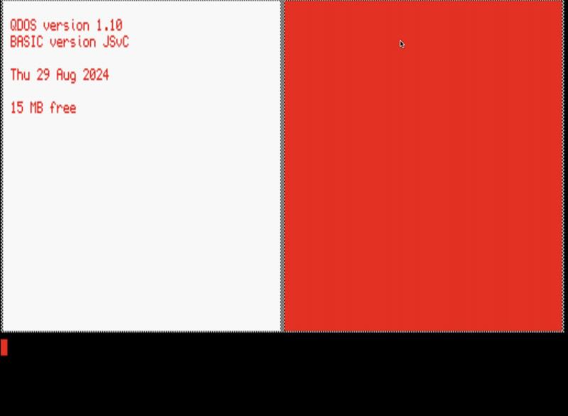

I noticed that on sqlay3 the ROM is writable and RAM wraps around every 16K. So with values of "ramsize" close to 16K this caused the RAM integrity check to continue past the end of RAM and overwrite the ROM.
The following adds to the previous patcher and replaces the RAM integrity check with one that handles systems where RAM can wrap around and where the ROM area is writable.
It requires an original JS ROM file and outputs a patched ROM called "JSvC".
