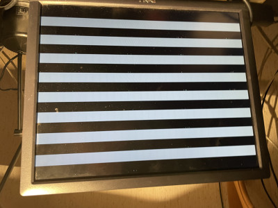

Problem with Minerva rom solved
Post by Fred de Boer »
In may I posted a problem that I had after I installed the minerva rom, a screen with just bars and later I tought that I solved the problem by inserting the rom in the other socket and had the normal screen again but some days later I move my QL and the problem was back again and the i found the the spring of the reset button was a bit lamé and die not push the button out again and now rhe problem is solved, a pic of the crazy screen osvattached
