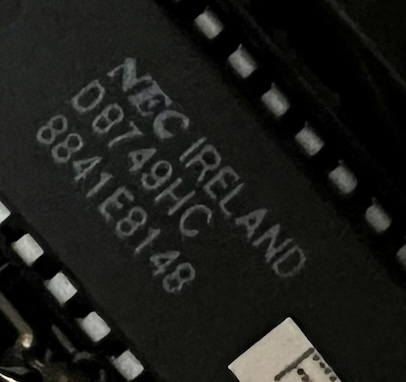

Posts: 3124
Re: Hermes to Modem Question
Classic 8749 symptons with modems! This was a replacement for the 8049 original second processor intended to cure keyboard debounce problems with replacement keyboards. Had side-effect of sabotaging modem communications!
https://qlwiki.theqlforum.com/doku.php?i ... r&s[]=8749
Posts: 985
dilwyn wrote: Thu Jul 11, 2024 5:07 pm Classic 8749 symptons with modems! This was a replacement for the 8049 original second processor intended to cure keyboard debounce problems with replacement keyboards. Had side-effect of sabotaging modem communications!
Many thanks for the info Dilwyn. A bent pin also probably wasn't helping much either!
Have re-fitted my 8049 for now
