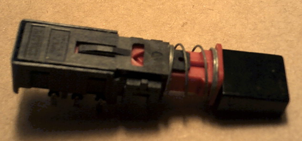

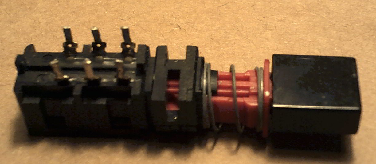

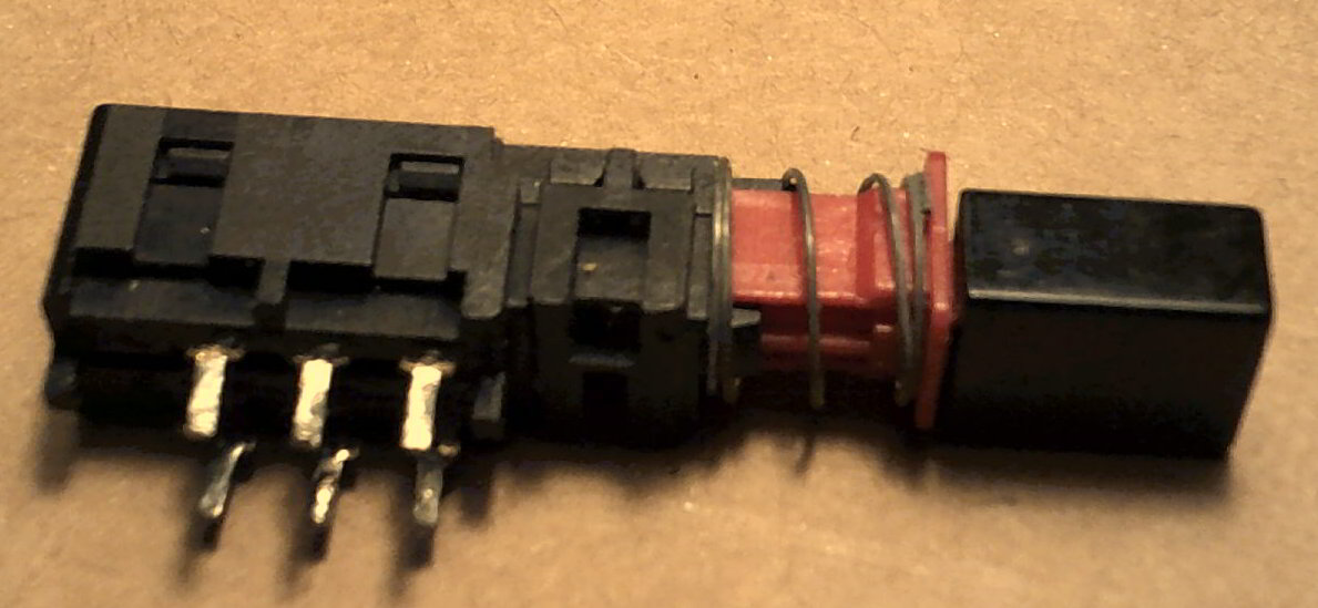

Hi all,
Today seems to be a lucky day.
After a very long time looking for a s3 replacement, switch for reset even in Ebay but without luck, it seems I have found the direct replacement on Aliexpress.
Edit:
https://es.aliexpress.com/item/1005005417029603.html
Not tested yet but checking on specs looks that is the right one.
I share it with you for:
1. If somebody confirm it that match it.
2. If somebody else need one, could use that.
Perhaps that needs some mods to fit it or adapt it, not sure yet because I am awaiting for it.
But I'm so happy to find it that here we go. Forwarded before testing it.

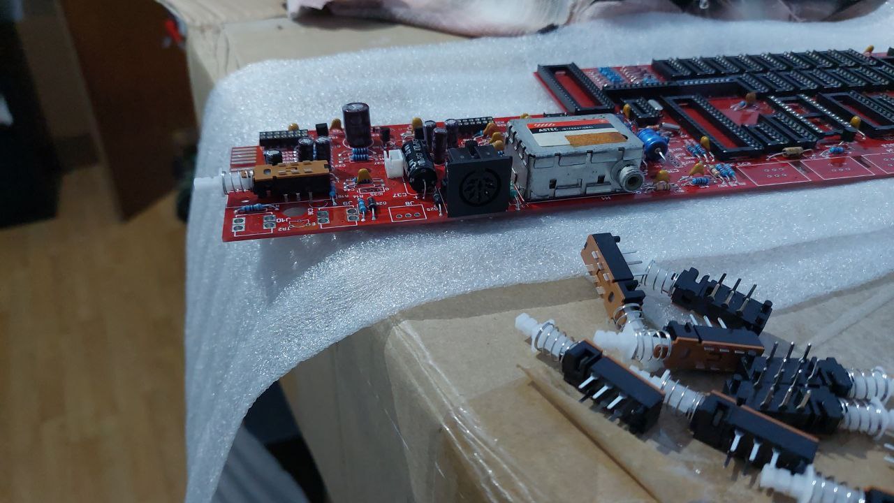

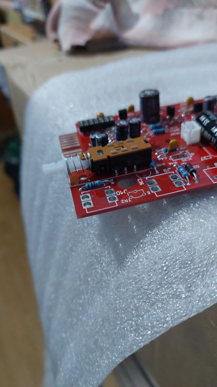

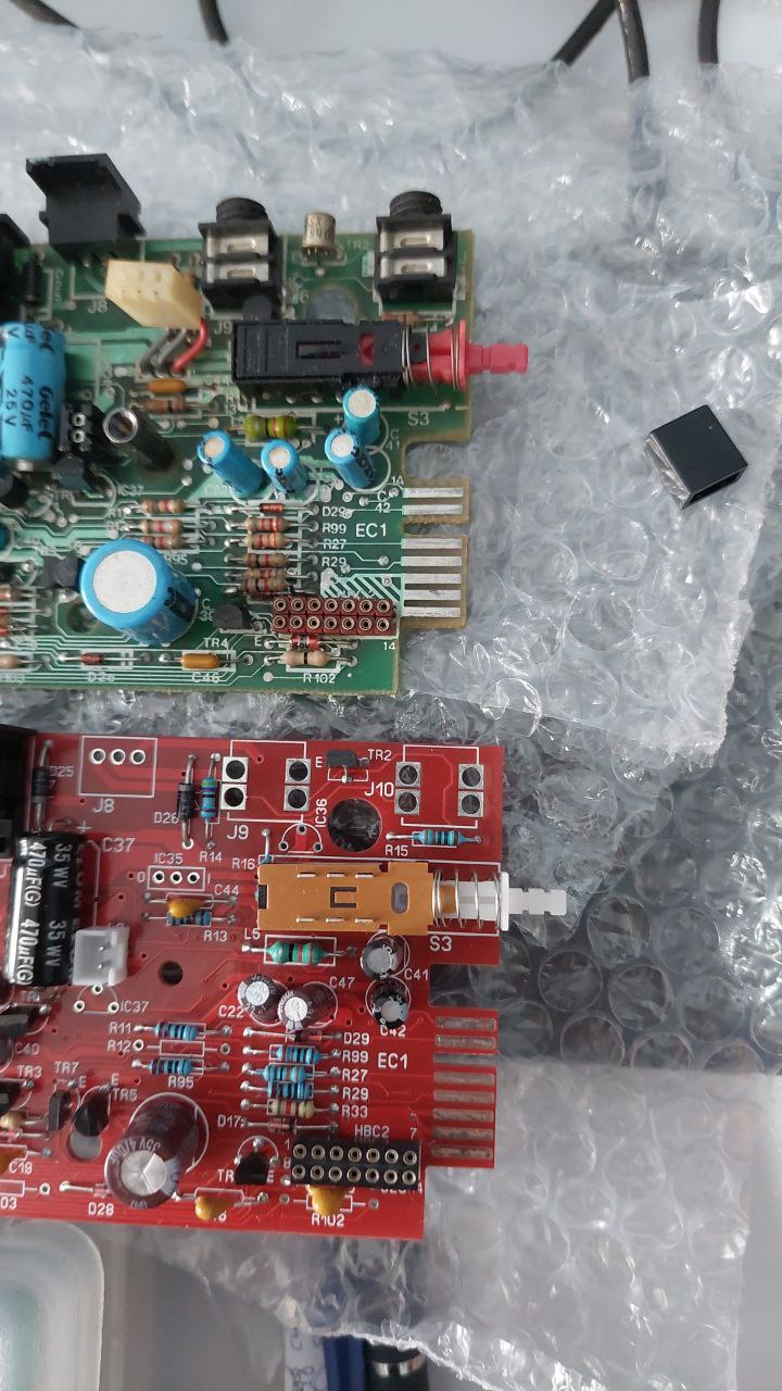

Hi all.
Got them and ...
Perfect.
Not sure if needs to be OC or CC by default. But how it can be modified... that's fine for me (I think)
Popopo
Posts: 531
Re: S3 Reset Switch replacement
Post by Popopo »

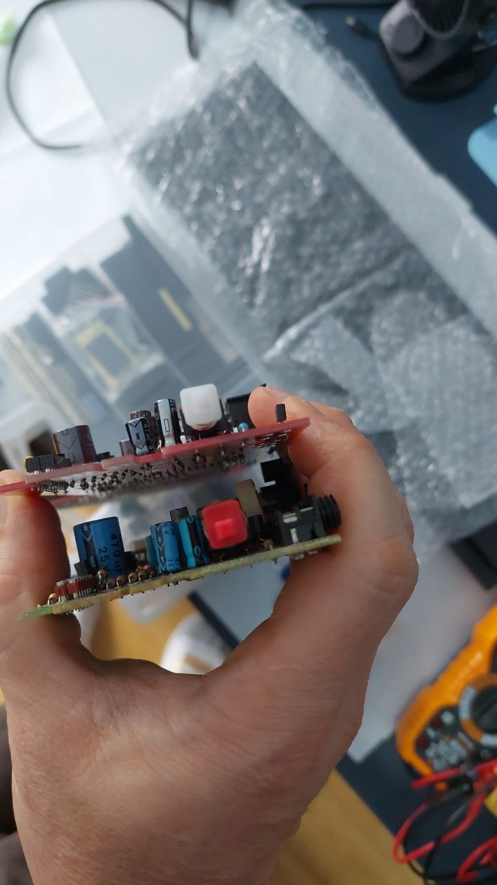

Finally full test :)
Very low cost for that replacement... bye bye Ebay jewelers.
Be aware!!!
In case you have the original heatsink, that replacement has some pins on the tip that should be covered in order to about accidental contact with the metal of the heatsink.
Enjoy it my dear colleagues!

TitoxUnix already test it out and worked perfectly.
He made a video but it is not public.
Just please remark about the upper part of pins are metallic and should be covered if you have the original heatsink placed. Cause it could produce shortcuts.
