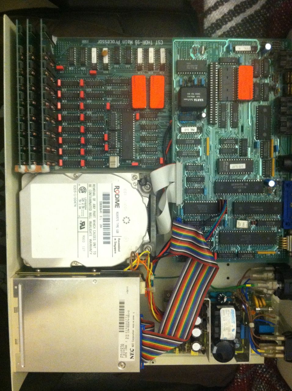

The mainboard says it is a CST Thor 16, and NOTHING inside the case is at all familiar QL hardware. Here's a photo, attached.

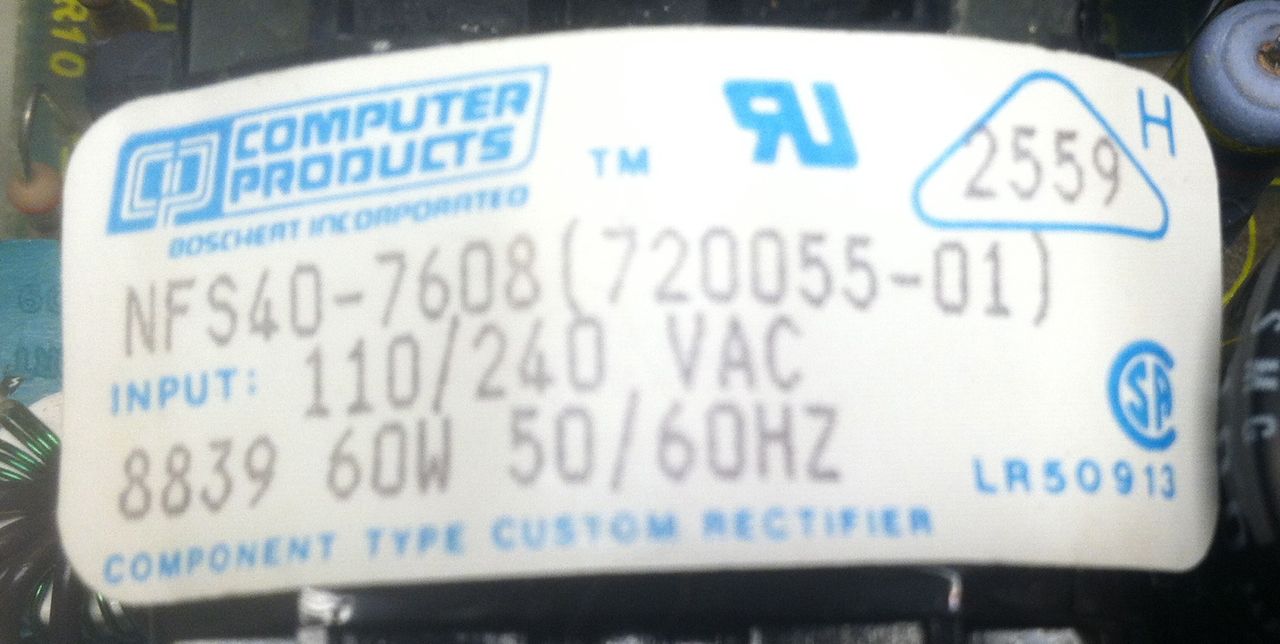

I checked the PSU and all voltages look normal, within expected ranges (5.2v, 11.78v, -12.03v). There are at least half a dozen PAL chips, and one Varta battery that is almost certainly dead.
Looks like there will be much manual reading in my future.

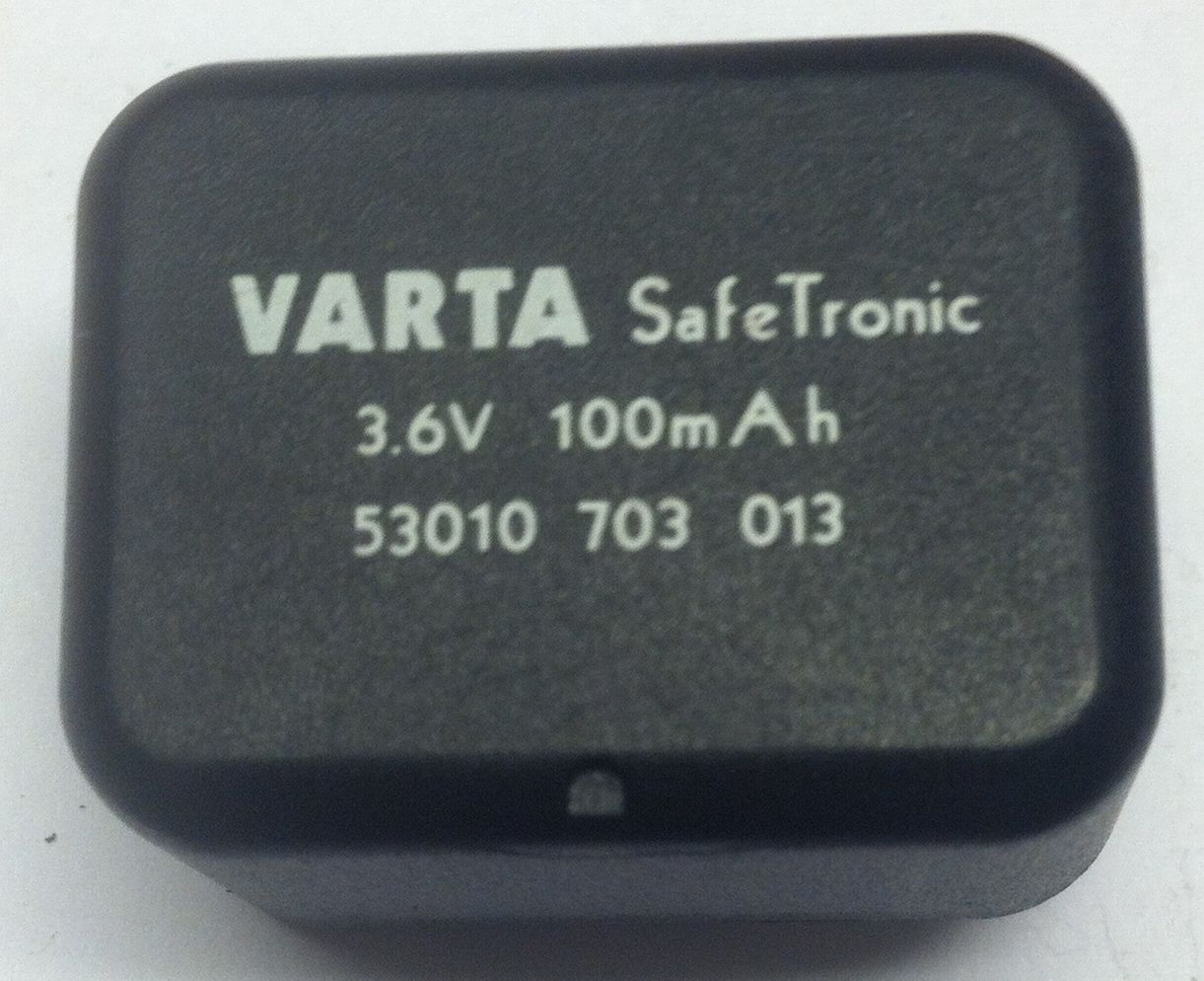

One definite thing would be the battery - The old Varta block batteries tended to break and leak even after two years and it could well be the battery has done a bit of "unintended PCB etching" under its body over time. Unfortunately, what leaks out from there is conductive acid! Remove it and clean the PCB under and around it. It could well be the problem.

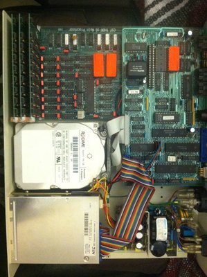

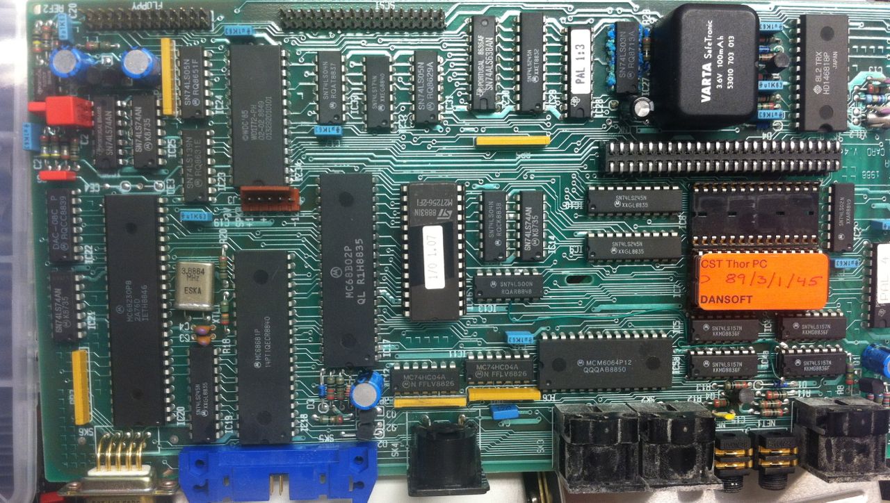

Well, I had some free time, and so I used it informatively.
I'll attach the photos, and draw conclusions in the next post.

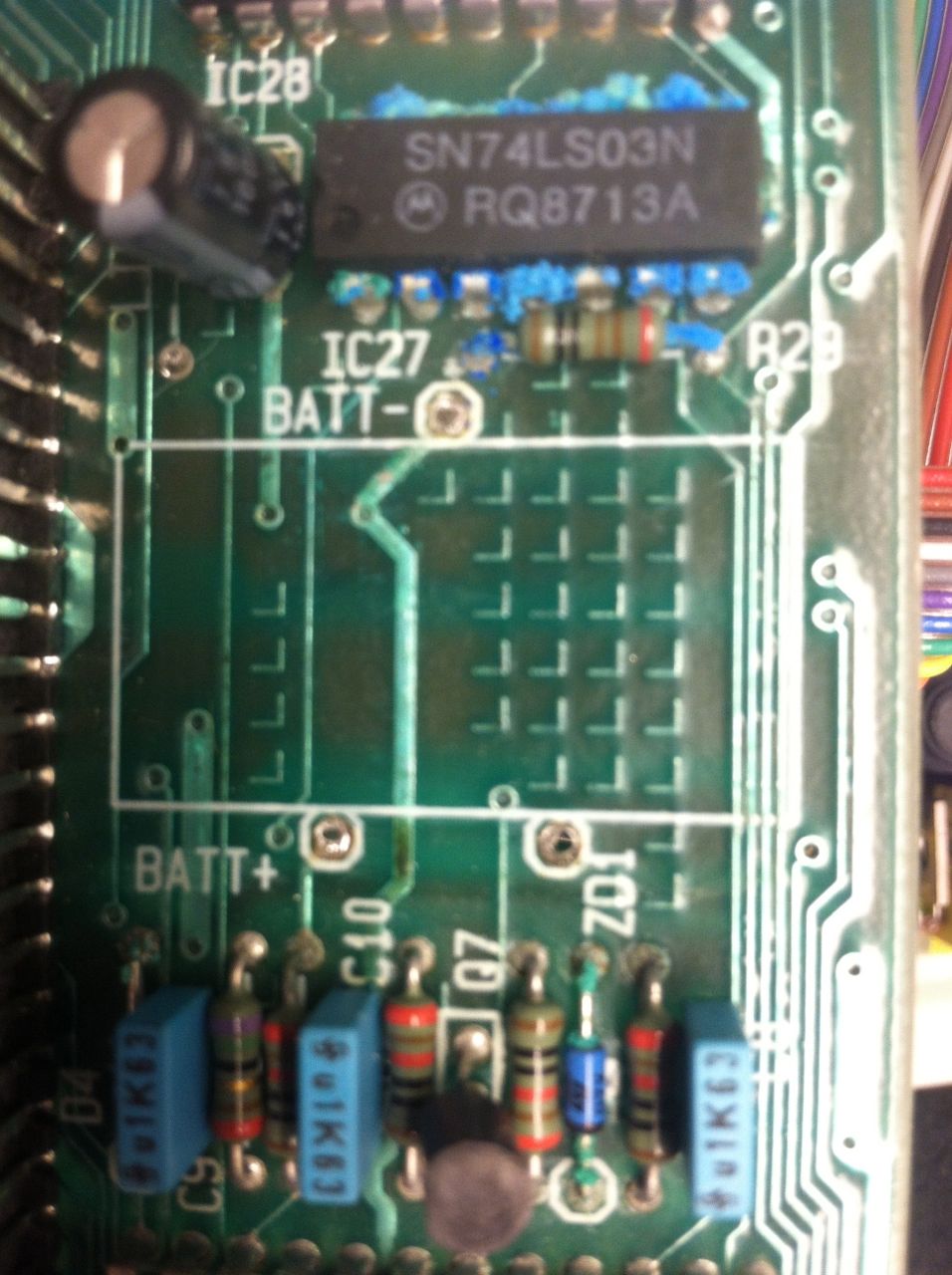

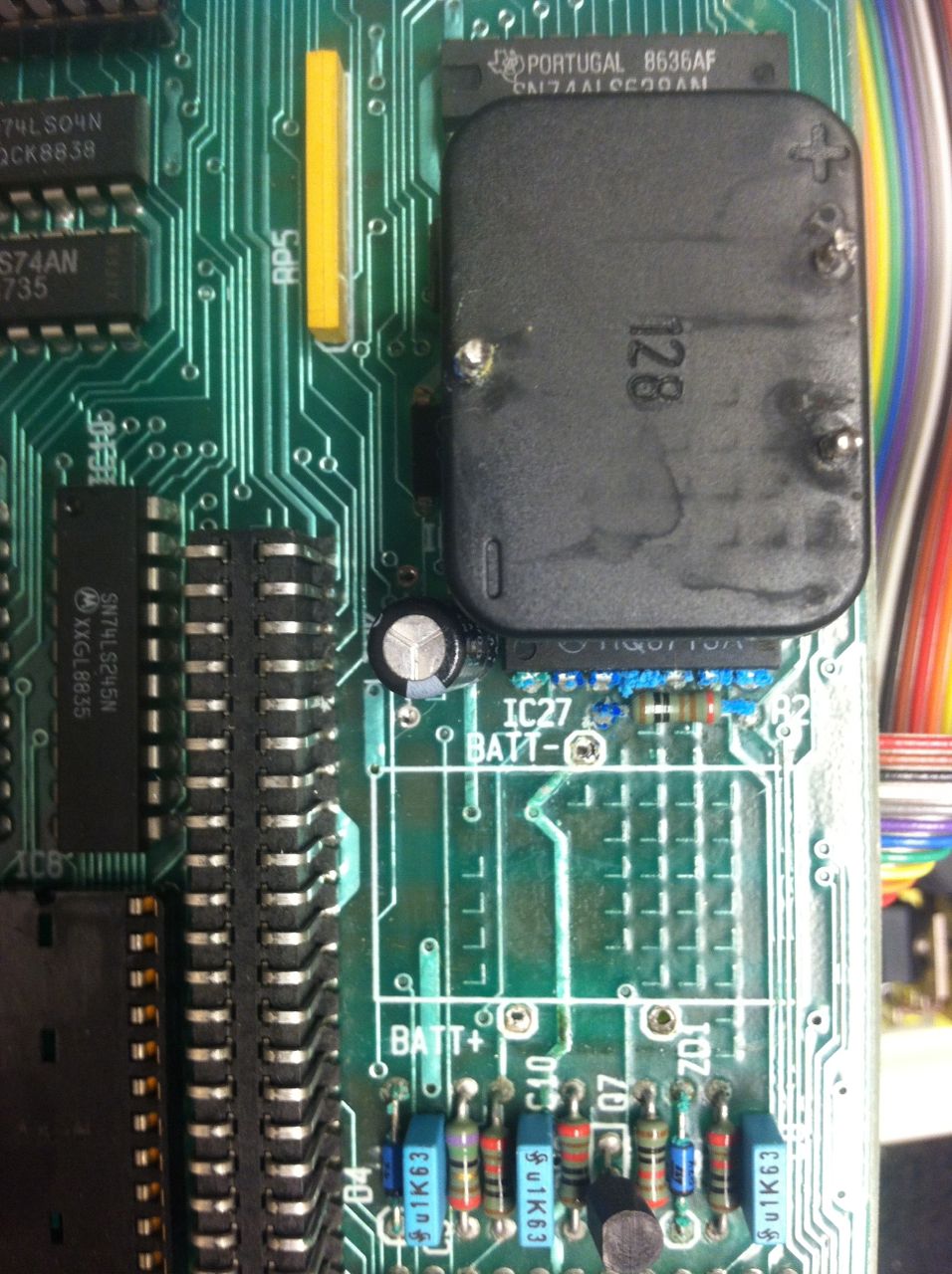

Posts: 2798
Re: Thor blank screen on boot...

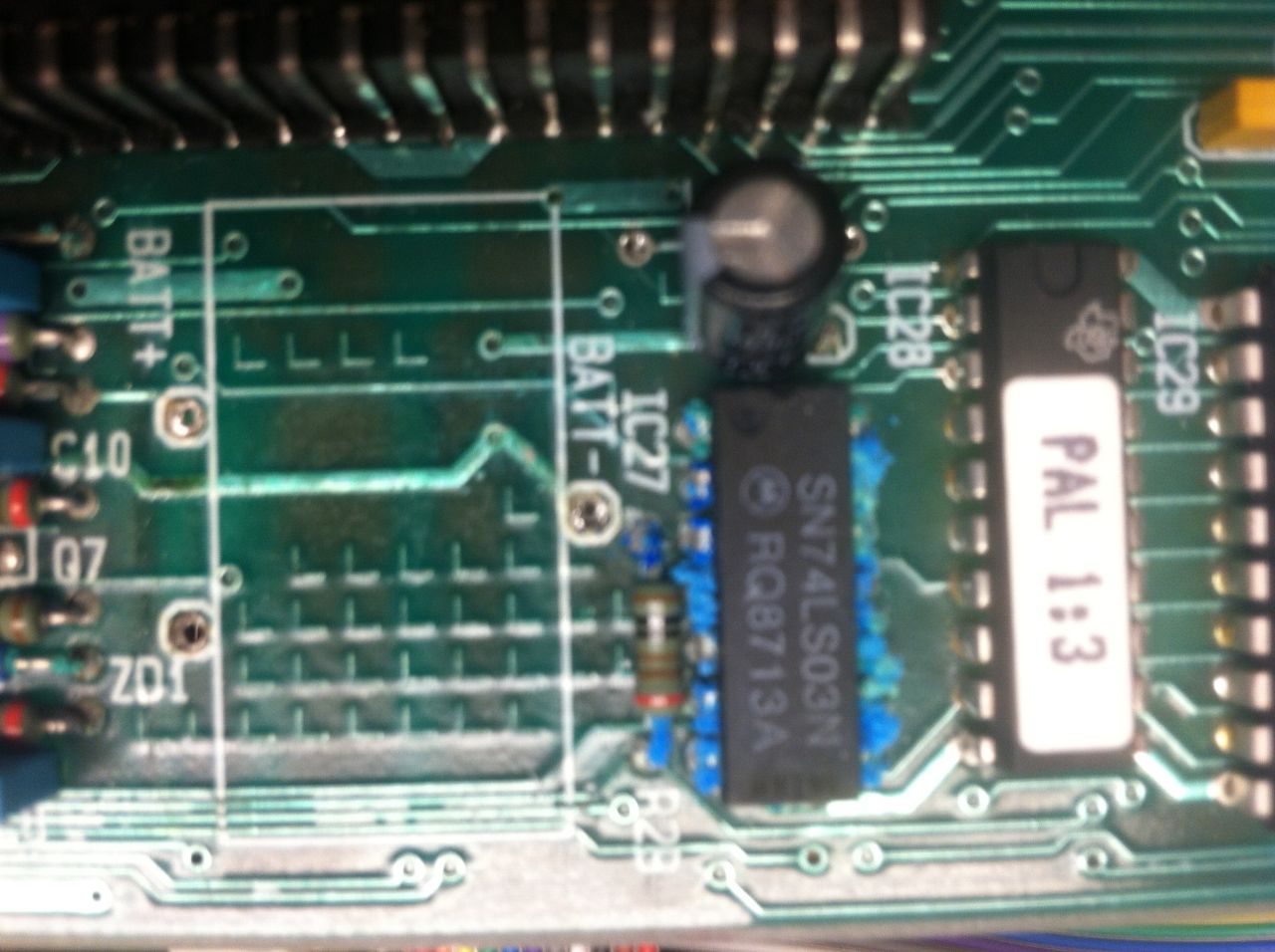

As you can see, the battery leaked, and there's a blue corrosion and crystalline growth on the 74LS03 next to the battery. I will clean this first to see the state of the components, and desolder the 74LS03...
More in a little while...
Posts: 2798
Pin 10 of the 7403 (IC27) was corroded through. This means corrosion could go inside the plastic encapsulation, so the IC needs to be replaced. The acid also ate some of the through hole plating
Also, the 100uF cap (CE1) adjacent is toast. The 1kOhm resistor (R29) is good.
I have 100uF caps in hand, but no spare 74XX03...

I read the technical manual, and the board expects a NiCad pack of 3.6V in that space, which discharges over a two week period, and is charged whenever power is on. I can make a suitable pack from three 1.2v LiIon cells and a single chip charge controller. Most LiIon cells these days for retail use contain charge controllers within the AA battery package, anyway. I will post photos when I make it. If anyone would like additional batteries made, speak up now!
