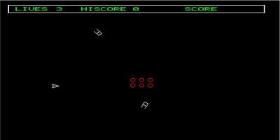

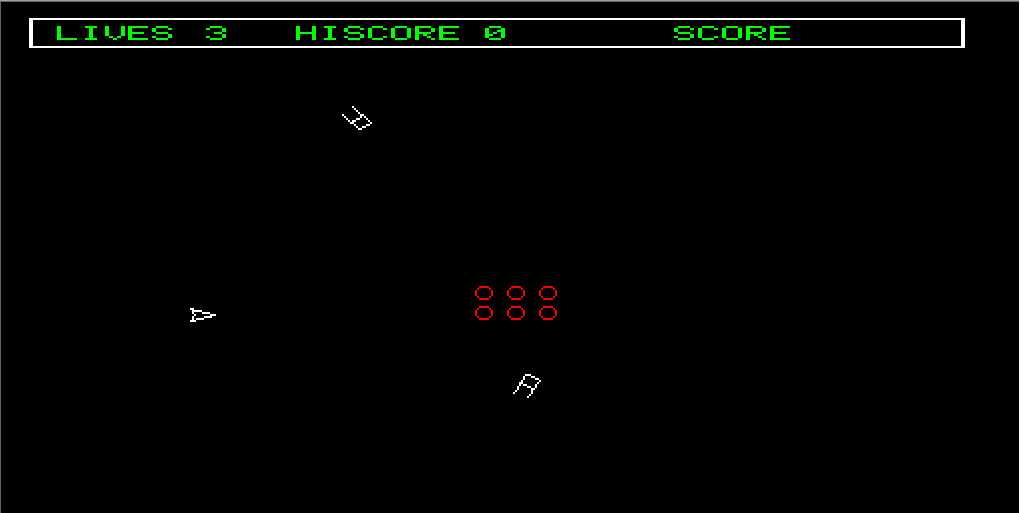

The SpacePods MDV on the games page on my website is for the MIST FPGA system. If that's where you got it from, it's possible it might not work properly on QLay/QL2K anyway. The other version on my site is just two standard files, a boot and a _cde file, so can be used on most systems. (I've assumed we're talking about the same game here of course!)
QL2K recognised the .MDV file after unzipping it. I LRESPRed the _cde file to start it and it seems to work, surprisingly. I only played it for a couple of minutes (admission: I am useless at arcade games!).
For anyone who doesn't know it, SpacePods is a kind of Asteroids game by Simon Quinn, where you use the arrow keys to control the craft and space to fire. To my surprise, the game not only worked, it ran at the speed I expected, without the excess key speeds you experienced. It had also had quite good sound, which surprised me as I hadn't bothered to check if I'd set up the QL2K sound settings or not. Screenshot attached.
