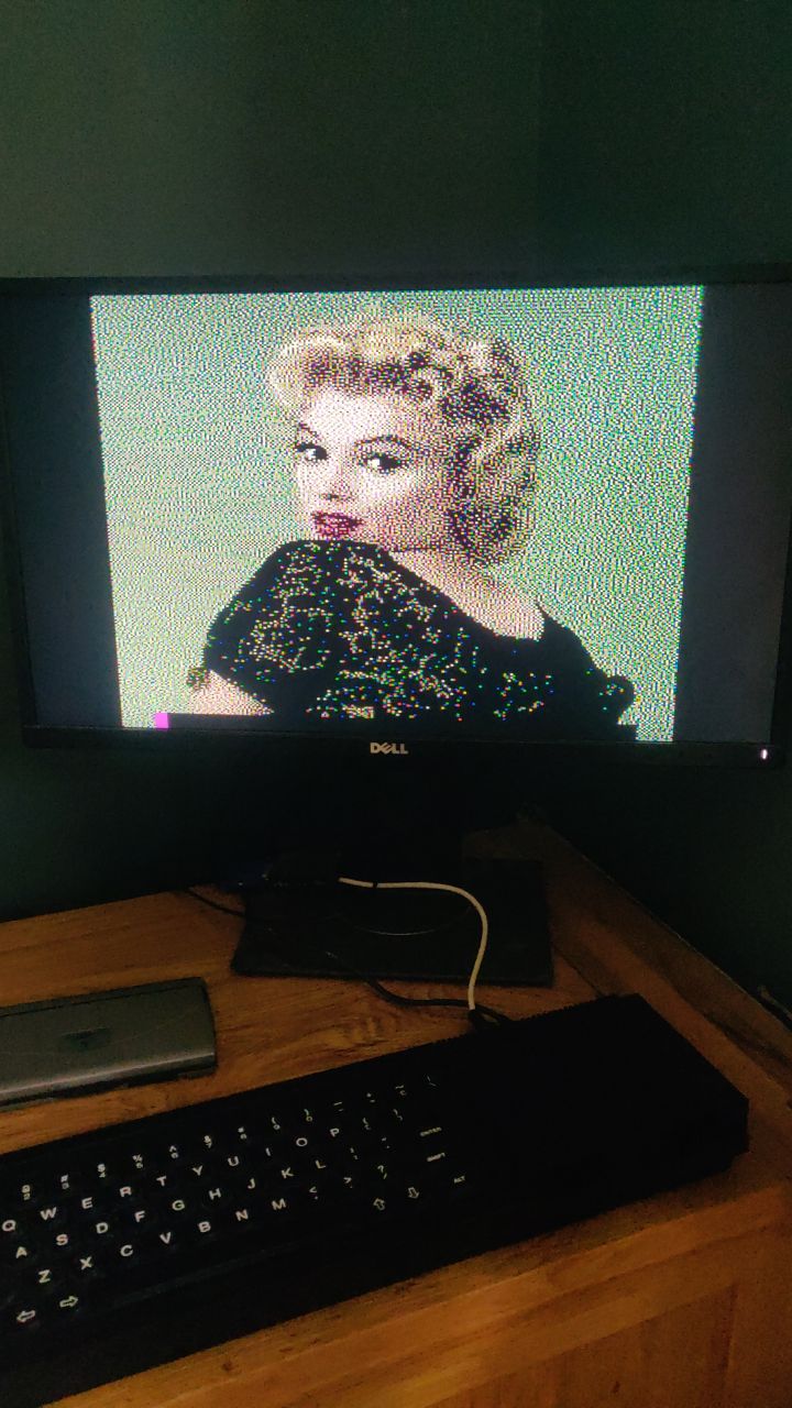

Re: Picture or image format for the ql
Success!
Not sure what the screen address is for 4colour mode
