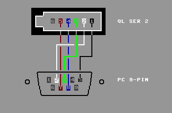

I have a very good quality usb to serial adapter that I use flawlessly with the Z88. It has full hardware handshake. The z88 is very picky.
I made my own QL adapter, it's possible I made some error here. I will check after work. See diagram below. Maybe handshaking lines are not correctly wired (RTS/CTS)
I have tk2 ROM installed
I used ser1 on both machines. Is ser2 wired different?

Cable design:
Ps, I have the correct ql plug.

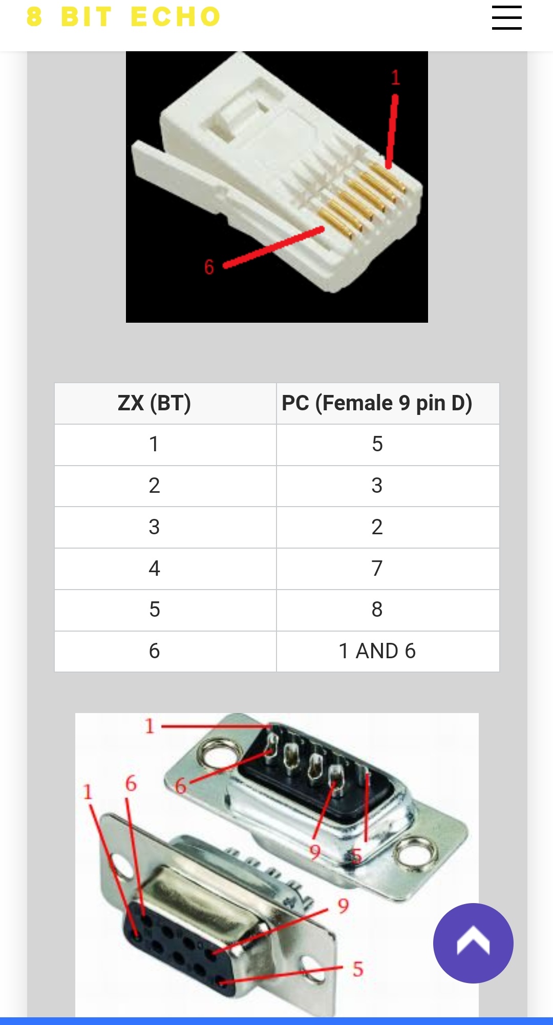

Actually I noticed my cable is different from this diagram...
From
https://oldmachinery.blogspot.com/2014/ ... l.html?m=1

A. Did you use the device names 'ser1hz' or just 'ser1'?
B. The 2x SER ports on the QL are indeed wired differently - RX/TX and RTS/CTS are swapped between them, so I would expect you to need a different wiring than you show in that image for SER2. (SER1 is wired and labelled as if a DCE/modem, whereas SER2 conversely as DTE/host.)
C. Can you estimate how many bytes actually transferred in each instance? Between the buffer in the IPC chip in the QL and the software buffer maintained by QDOS, there is only about 90 bytes buffering available, before the QL would attempt to pause the event flow by deactivating it's RTS (really CTS!) hardware handshake signal line.
D. Is your IPC the original 8049 or the updated 'Hermes' replacement (which is MUCH more reliable!)?
I still suspect that handshaking is somehow not being enabled. It could be that DTR or similar at the PC/USB to Serial adapter end also needs connecting to the '12v' line (pin-6 at the QL), but don't go there yet...

Your cabling looks correct,aybe the hand shaking and flow control is not right.
Try using terminal programme at each end of the serial cable.
For more info on RS232 try this link:
https://www.lammertbies.nl/comm/cable/rs-232
