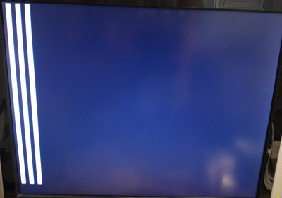

Just got my Merlin Tonto out to try out Stephens' C1 disk interface clone. I didn't get as far as plugging that in though, as I get a chequered pattern and then this screen with 3 vertical lines on boot:
It was working a few months ago when I packed it away.
Likely RAM issue? I can't find any info that mentions 3 white lines as a diagnostic aid. I had a spare CPU so swapped that, no difference. I pushed down on the socketed chips and also removed and re-plugged the daughter board, no difference. I felt the chips to see if anything was unusually hot - it wasn't. I piggybacked a 4164 RAM chip on each of the soldered RAM chips, minor pattern changes occasionally, but no real difference, still 3 vertical bars.
