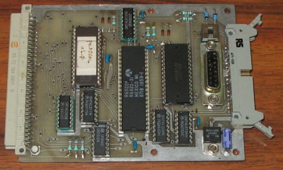

The Connexions series ran from December 1986 to September 1987 issues of QL World. Read them as PDF files at https://dilwyn.theqlforum.com/mags/index.html
Ql Wiki has a short article on the Qontrol II board, at https://qlwiki.theqlforum.com/doku.php?i ... l_ii_board
Here's a picture of the board. I used to have one many moons ago, which I bought ready-made from (I think) Care Electronics. I sold it in the end after the novelty of using it had worn off, although I did have fun connecting a few simple bits of hardware to it (without destroying my QL!). Afraid I don't remember much about it, it was in the 1980s after all.
Qontrol II board
Qontrol II board

dilwyn wrote: Sun Jul 16, 2023 7:20 pm
tofro wrote: Sun Jul 16, 2023 5:02 pm QL World (or was it QL User?) used to have a series on the so-called "Quontrol Board" that provided a number of GPIO lines, and, I think, A/D and D/A conversion. I'm pretty sure they provided schematics and a PCB layout, and I also think there was a limited run of boards they sold. That was pretty early in the QL history, if I recall right. It's unlikely you'll find such a board, but the magazines should be a possible find, I guess and with tools available today and PCB manufacturers providing PCBs for cheap, there could be a way to reproduce this board.
Hi Dilwyn,
I can not find any PCB layouts or circuit diagrams, just article and photographs of the top side of the PCB.
Here is a PDF of the QL Wordl article:
qontrolii.pdf
(459.7 KiB) Downloaded 83 times

Posts: 3143
Re: QL IO board?
Derek_Stewart wrote: Mon Jul 17, 2023 8:50 am
Hi Dilwyn,
qontrolii.pdf
Do you still have the QControl board?
Sadly, I haven't got the board nowadays, and I can't remember who bought it off me. Otherwise I'd ask them to try to take good quality photos of the circuit board to see if it could be reverse-engineered.
