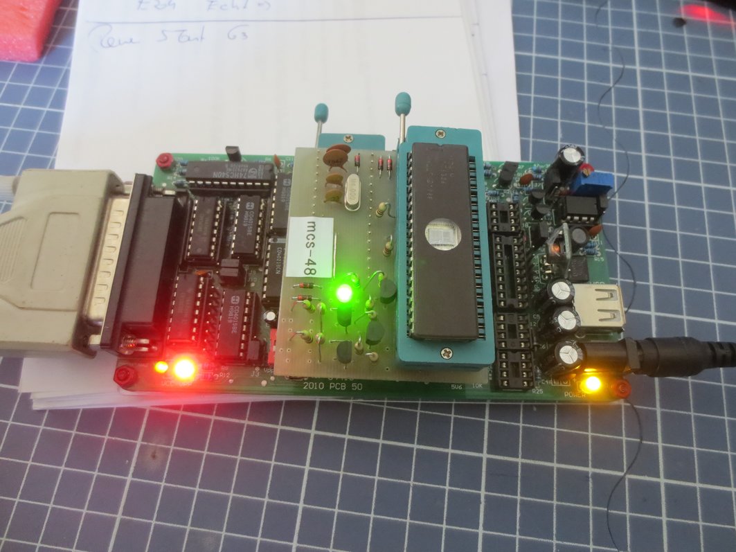

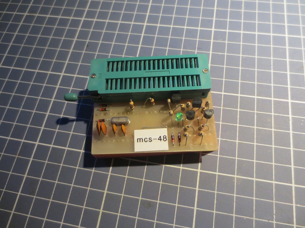

jobdone
Posts: 116
Re: hermes remake or diy solution ( for the classic version ) - solved -
Post by jobdone »
