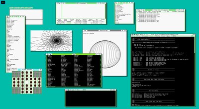

Further to my previous post; I had another go of outputting SMSQE at HD resolutions from a PC onto a TV. This time I was successful and the result is very nice. For multitasking systems the higher the resolution the better, in my opinion.
I would like to be able to do this from a PI 400.
The following is a screenshot of SMSQE in SMSQmulator running on my Lenovo laptop connected to a TV at full HD resolution.
how this happened and can only apologise for the error. Maybe the forum controller can correct this.
