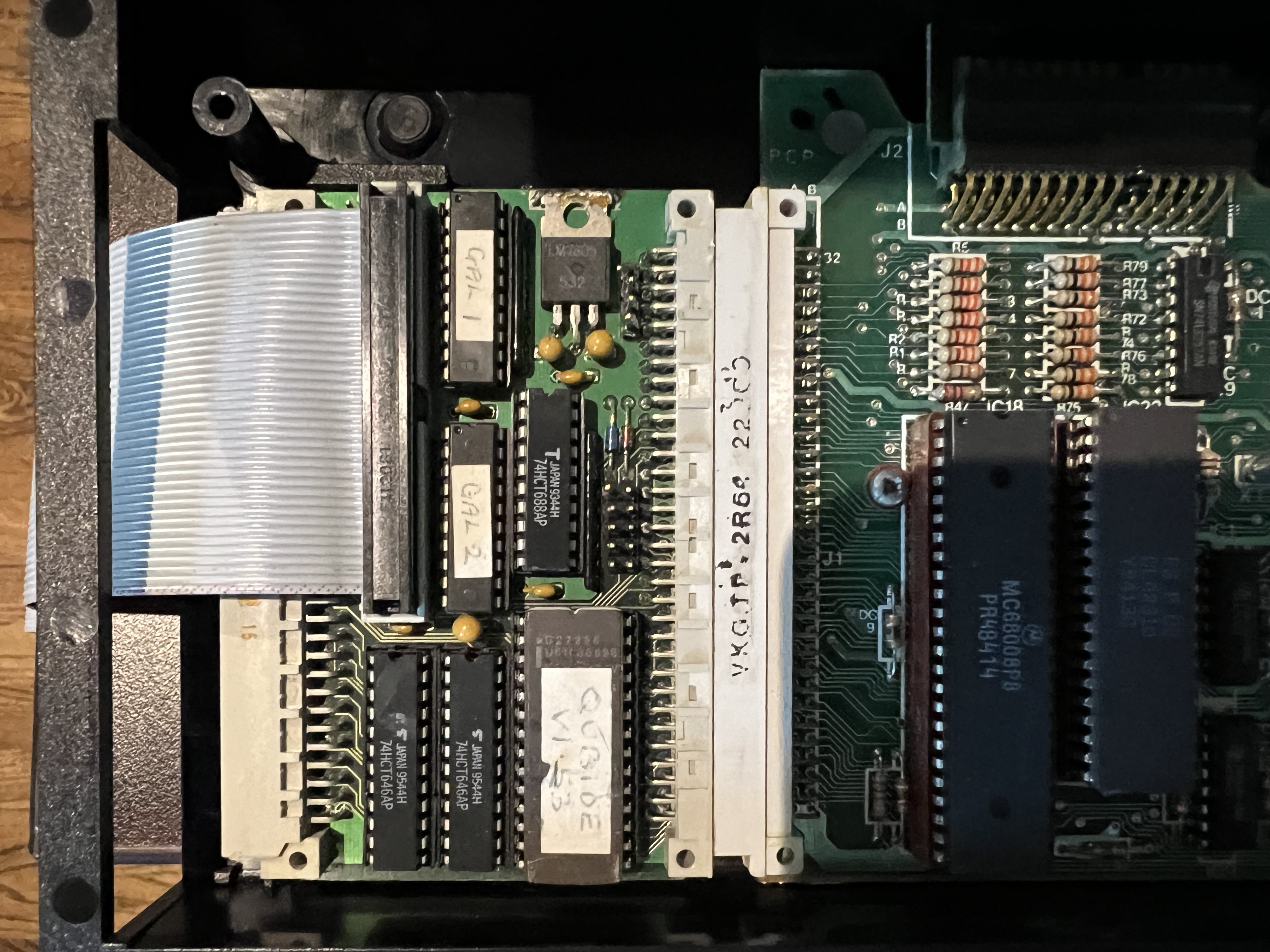

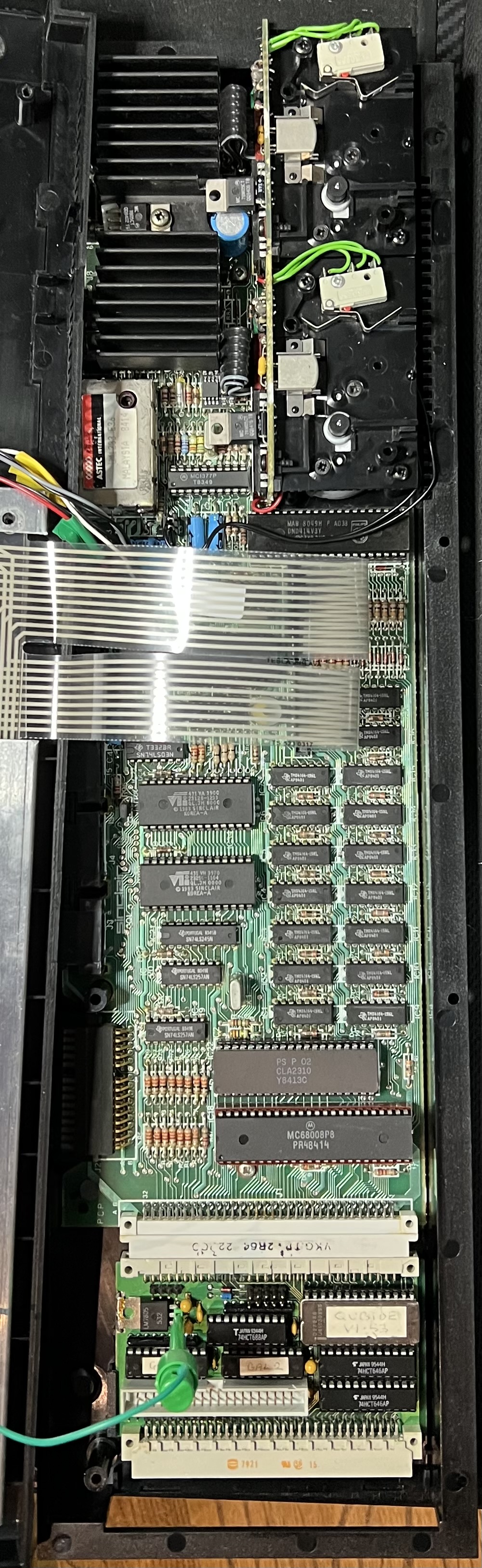

I was recently given an old original QubIDE, which I'd like to restore. After giving it an IPA bath, I plugged it into my QL - looking something like this:

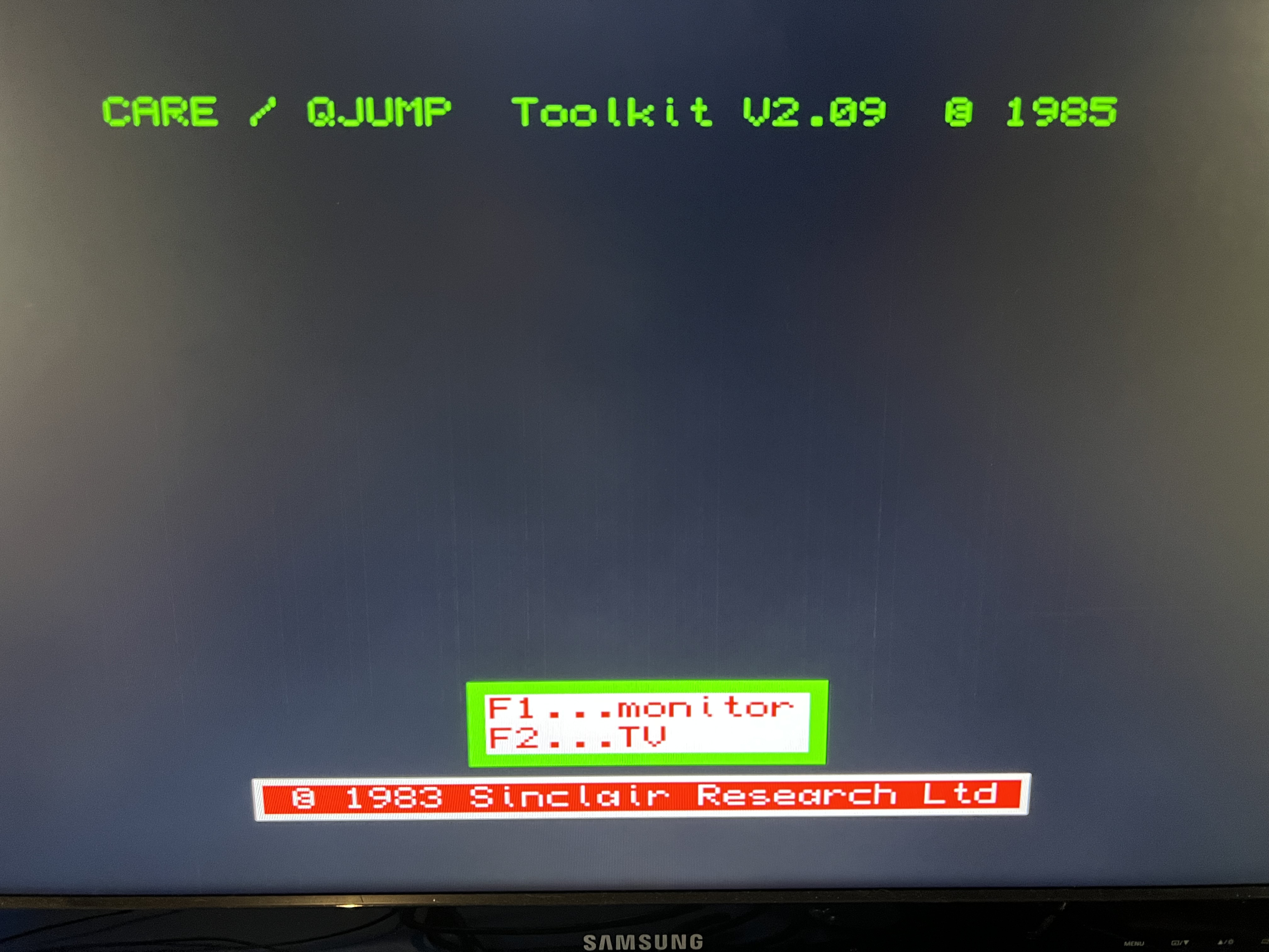

Unfortunately the startup screen didn't display any QubIDE message... although the QL was functional.

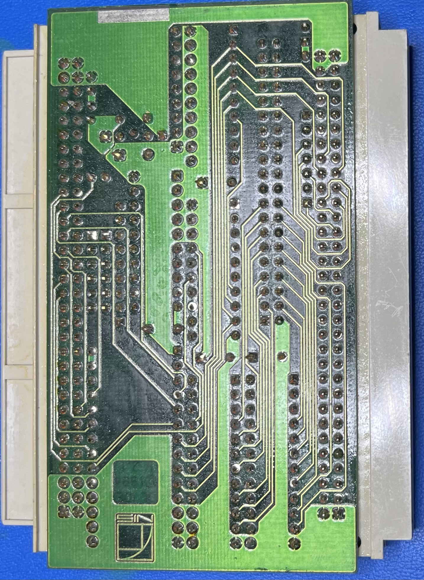

I tried re-seating and contact cleaner, but to no avail. I also checked for dry joints...

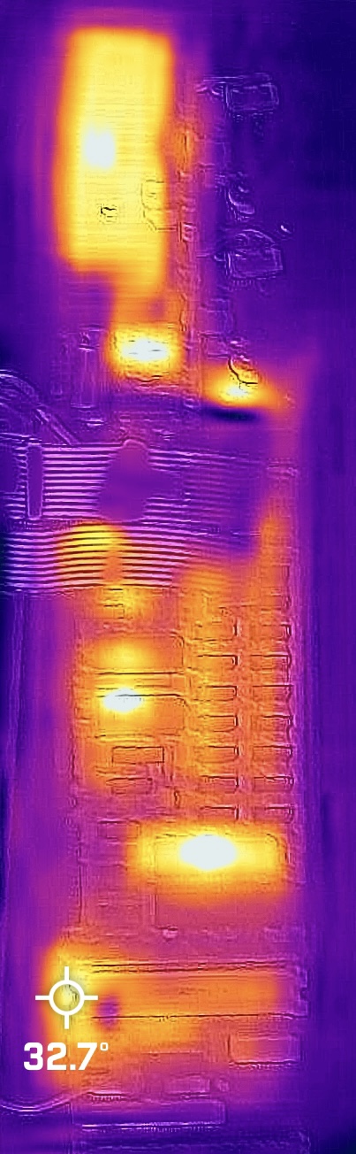

None of those. So next I did a thermal picture to see whether anything was happening:
And a measurement of the 7805 read 8.8 V input and 5.0 V output.

Your QubIDE is jumpered to I/O address $FC000, which will only work on newer ROMs and Minerva (Earlier ROMs - before JS, if I remember right - don't look for expansions in this area due to a bug). Depending on your QL ROM version, this might be the reason why it doesn't work.
I would try a setting a base address of $C000, which was the standard setting (QubIDE then occupies the ROM slot space) first and work from there. $C000 should work on all ROM versions. To set $C000 as the base address, the three right-most jumpers (when you look "into the QL") on the five-position jumper block should be set. Note that if you jumper the card to $C000, you can't use the ROM port at the same time - but this position is the easiest and safest one to check whether the card is working at all. If it works there, you might want to think about a ROM upgrade to JS or Minerva and base the card back at $FC000 to make the ROM port usable again.

Thank you tofro. My bad for not RFTM-ing more carefully - "Once you have set up QUBIDE to the address you have chosen..." The issue was as simple as user error: not having appropriately set up the address :oops:
The ROM version (interrogated using print VER$) on my test QL is JM. If I'm not mistaken, that would seem to be one of the earlier versions where the whole ROM addressing issue wasn't as flexible as it became. I note your suggestion about upgrading the ROM... not sure what kind of Pandora's box that would open, but I'll give it a go!
Anyway with the jumpers set up as you suggested, and the external ROM I had plugged in removed "just in case", everything sprung to life... pretty impressive for hardware not used in 25 years!
