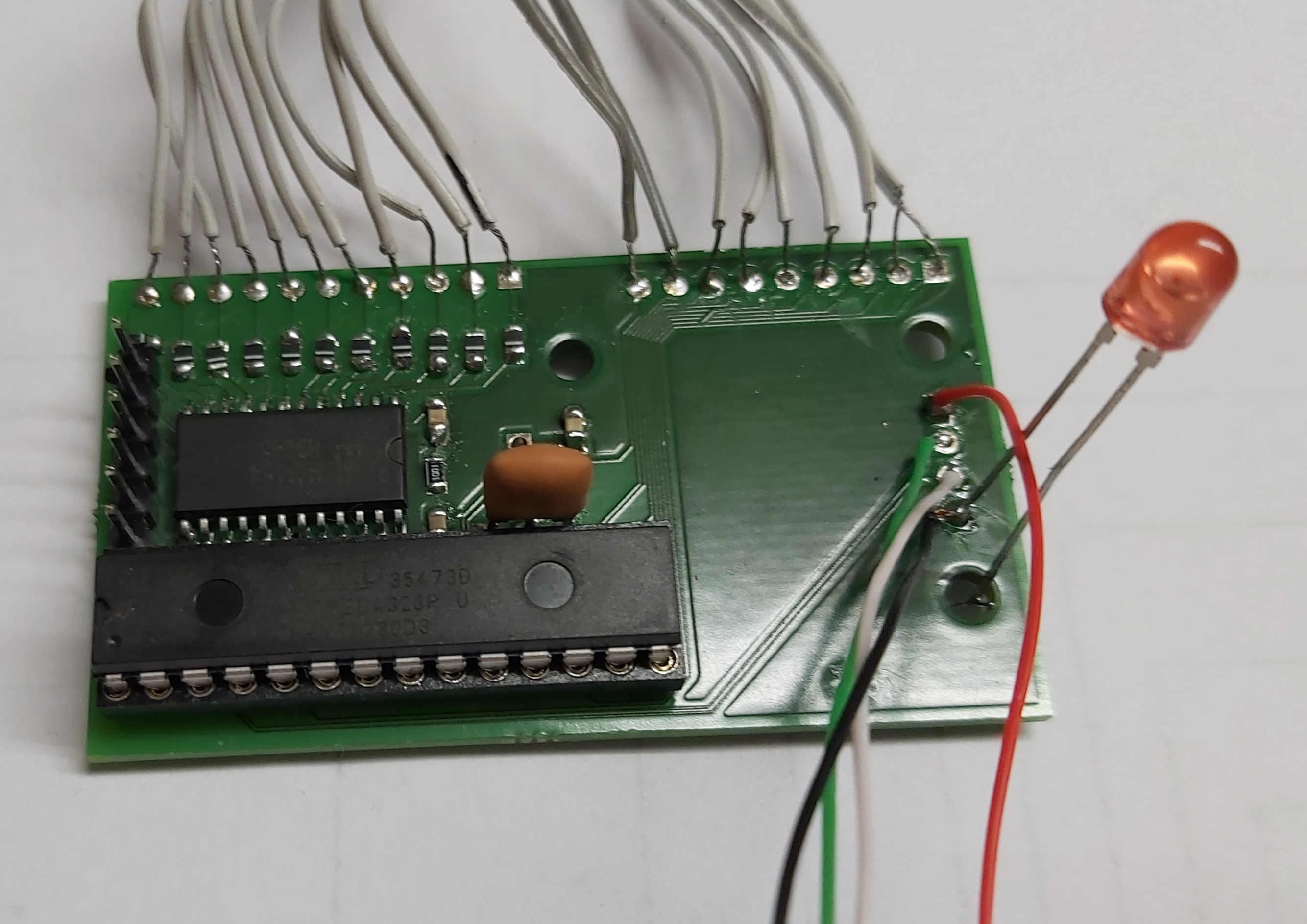

Hi all,
just want to share with you my latest small project. Its a Keyboard converter to attach the QL matrix keyboard to a PS/2 device, in my case to a Qzero.
It is based on an Atmega 328P. What has been achieved:
- Support all keys of QL Keyboard (of course, this was the aim)
- Support all key combinations together with ALT, Shift and CTRL, like CTRL + C and ALT + Q (e.g. to Hotkey QD). This was a question here: viewtopic.php?f=2&t=4012
- Supports two keys together e.g. A+B and also together with CTRL, ALT and Shift.
- UK and Ger QL keyboard layout
- Capslock LED
Ignore the bad soldering of the SMD components, its manual soldered. Ribbon cable can be directly replaced with proper keyboard membrane connectors.
I would really appreciate any comment, also any comment which special key combination should be tested or implemented to improve the use case.
Great thanks to Peter for designing the layout.
Stephan

Fantastic! Good to hear you got so much working already. :D
I have heard that someone built a Q68 into a QL case, and then used a QL matrix to USB converter plus a USB to PS/2 converter. Your project makes that so much easier and nicer.
And you are welcome for the litlle PCB design, that effort was very small compared to your software development for the AVR. It's simply nicer than a breadboard and PCBs don't cost that much these days. Please do with it whatever you want, it is freeware from my side.
Can you give us a few words on the development environment you are using?
Which AVR pin are you using for the Capslock LED? Probably PB5 like the Arduino Nano?
On my new QL baseboard I have connected PB5 of the AVR to the QL's yellow power LED. Currently dimensioned for about 16 to 18 mA, can the AVR drive that?

Maskenlos wrote:I would really appreciate any comment, also any comment which special key combination should be tested or implemented to improve the use case.
Nice job. A thought that is a bit late given you already have a PCB. If the ribbon holes lined up with the connectors on the QL you could use long pins and plug the board directly in to the QL eliminating the ribbon completely. I think there is plenty of room from the QL onboard connectors and the front of the QL case.
Posts: 2478
Re: QL Keyboard to PS/2
Ruptor wrote:A thought that is a bit late given you already have a PCB.
I have no problem to do some small changes to the PCB.
Ruptor wrote:If the ribbon holes lined up with the connectors on the QL you could use long pins and plug the board directly in to the QL eliminating the ribbon completely.
I do not understand what you mean. If the ribbon cable is removed, and connectors soldered instead, the QL matrix keyboard can directly plug in.
(This circuit does not connect to the QL mainboard but the QL matrix keyboard...)

Peter wrote:Currently dimensioned for about 16 to 18 mA, can the AVR drive that?
Hi Peter,
the ATmega328P has the following power limits:
* Per pin, 40 mA maximum, 20 mA typical and advised, but note port and board limits.
* Per individual port (PORTB, PORTC & PORTD) the limit is 100 mA each, maximum, but note board limits.
* Per ATmega328P in total (all pins/ports together) the limit is 200 mA maximum.
All of the above are source or sink -- the ATmega328P is symmetrical in this respect.
HTH
Posts: 2492
I was wondering, sort of, if it's necessary to run the ATmega328P at, I presume, 16 MHz? If you could run it at 8 MHz, then you can do away with the external oscillator thingy (or a crystal and 2 capacitors) and gain two extra GPIO pins -- Arduino doesn't use them given it's hard wirded at 16 MHz, but PB6 and PB7 would then be available for "other things" if necessary.
I "designed" a NormDuino some time back to run at 8 MHz, and still be able to be programmed with the Arduino IDE, details at http://qdosmsq.dunbar-it.co.uk/blog/201 ... readboard/ if anyone is interested. I have a couple running on breadboards for various tinkering "projects", but nothing special.
Oh, and by the way, the Arduino standard fuses are, I think, wrongly set for the Brown Out Detector! When running at 16 MHz, the lowest power advised in the data sheet is between 4.0V and 5.5V. The default BODLEVE2:0 fuses are set to reset at 2.7V which is way below minimum spec for 16 Mz. I think it needs to be set to 4.3V which is the next BOD setting up.
Default BODLEVEL2:0 are 101 for 2.7V. They should be 100 for 4.3V.
