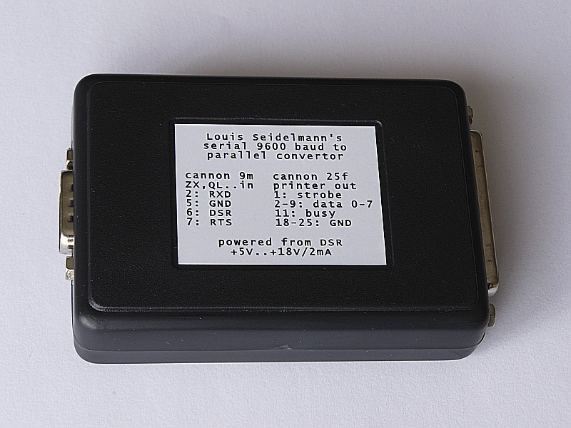

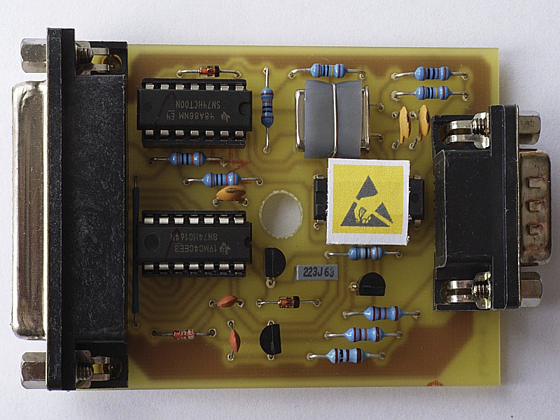

I do not have schematics for the Miracle interface, but I have some files from ing, Louis Seidelmann for his new (2015) interface.
He has 4800 and 9600 baud version of this.
About the Sandy interface (probably confused with Miracle?) he said, that it uses clever solution "using shift register and two timers".
SertoPar 4800 parts.pdf
(26.6 KiB) Downloaded 204 times
SertoPar-9600-ZXQL sch.pdf
(21.04 KiB) Downloaded 214 times
