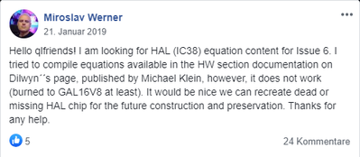

Has anyone programmed a GAL 16V8 with the JED code that was published (I think it's in the distribution and also on Dilwyns site too).
I noted the comment about using a slower GAL - got some on order - but was interested if anyone had done this and what was the result ?

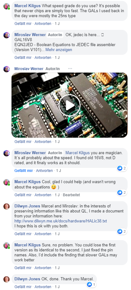

Pr0f wrote:Thanks Marcus - I am using a 'D' variant at 15ns - I have some 'A' variants at 25ns coming my way in the next few days - I will try again.
Symptoms with the D are a bit odd!
1488 chip got a bit warm - but it could be a bad one - running tests without that in place
Memory detected by Minerva on power up is only 64K, but sometimes it throws a memory error in the early 20000's memory range. So I may have some further RAM issues but I did solve one of these - missing address line on IC3
Haven't tested out ZX8302 access yet - that will be the biggy
I want to make sure this GAL isn't the source of any problems, since the other chips have all tested ok in another QL. Board is a T1 variant.
For Tx version you can use any PAL/GAL/ATF/PALCE with any speed.
You need to install C54 (47 pF ) capacitor.
For other QL PCB versions - capacitor 47 pF between pin 4 ( DSMCL ) of PAL chip and ground ).
