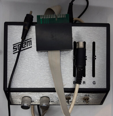

Here's an obscure bit of QL Hardware:- a SPEM Digitiser, V2.0 according to the PCB inside.
There is some software for it on Dilwyn's site called "LookShow_v2_13.zip". I've not tried it yet. I did find an article in QL World (Aug 1988 p26 onwards). The device has a ribbon connector for the QL ROM socket, a DIN plug for the monitor, a DIN socket for the QL monitor output and an RCA type plug for the video input (composite video I assume?).

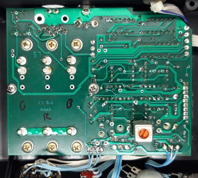

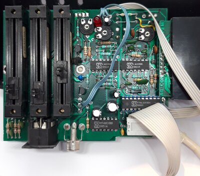

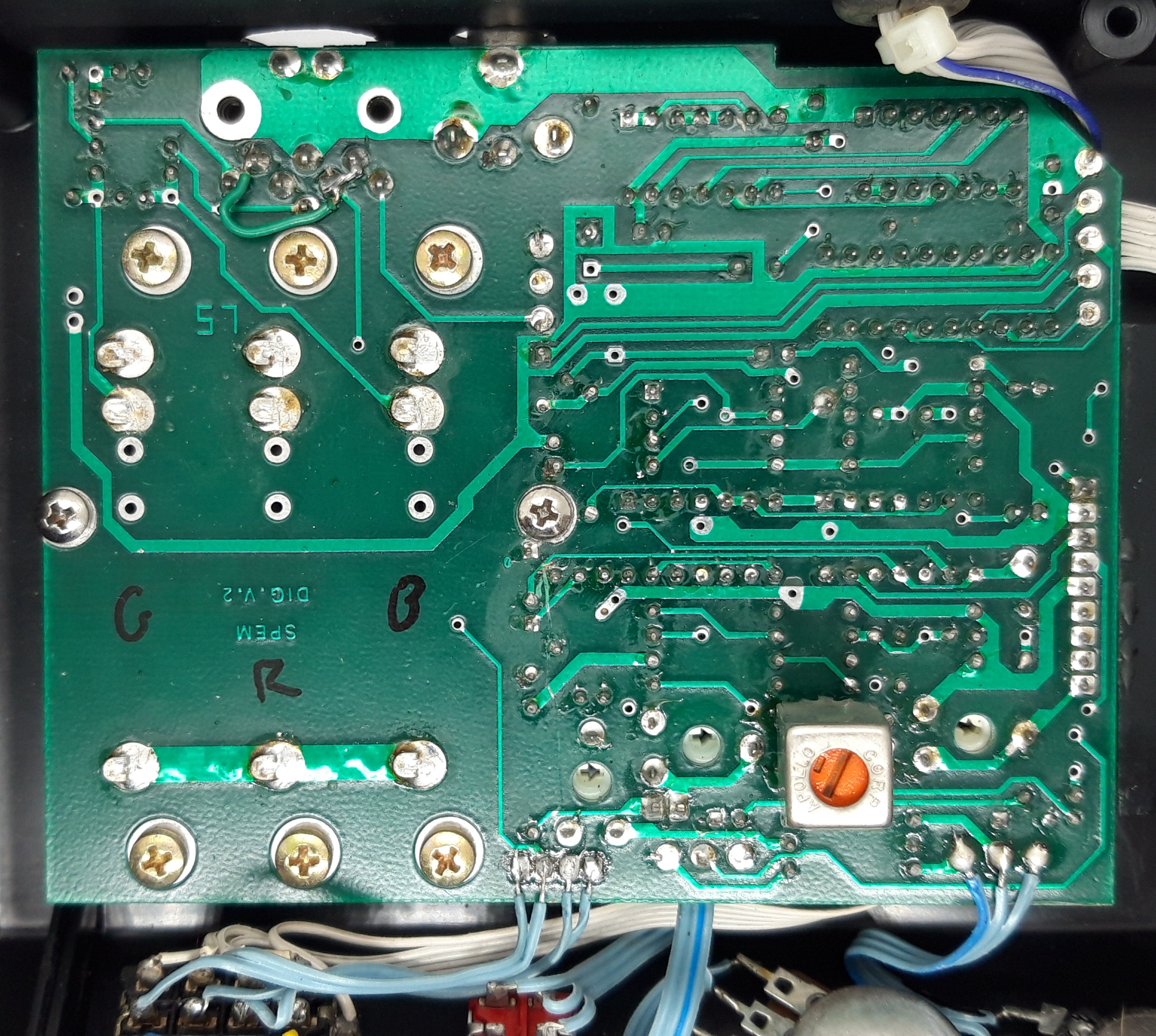

This is what the Spem Digitiser looks like inside.
On the right there is a secret black box daughter board attached to the PCB. It's innards have been completely sealed with epoxy.
The wider ribbon connector connects to the QL ROM socket, but only has a few pins connected, namely: 5v, A14, ROMOEH, A15, D7, D6, GND, D1, D0, A0. No text appears on the F1/F2 screen to indicate an external ROM.
I connected it to a standard QL and after removing a solder bridge across the green and blue wires in the connector it seems to show the QL screen properly and the RGB adjustment sliders work. I was also able to switch to an external video source but the picture wasn't great. I'll try out the software soon.
