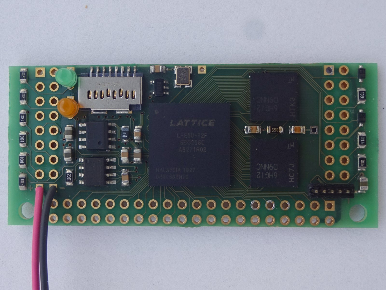

I might in part be responsible for slowing down Martyn's project by telling him about another piece of hardware which already can do the job.
I mean the Qzero, my tiny QL compatible computer in a sub-RaspberryPi Zero form factor. Among other things it can translate Serial/USB to QL network. But I'm not motivated for a series product at the moment. And the Qzero would be more expensive, since it has two SDRAMs, FPGA, microSD card, video, etc. So I hope Martyn will finish his work anyway.
What would be a reasonable price for a USB to QL network converter?

Cutting it down to just one, smaller SDRAM, the smallest FPGA, no microSD and tailoring it for USB-QLNET might be an option. But the board requires BGA machine soldering, which makes no sense for 10 to 20 adapters or so. A QNET to USB adapter could turn out a low quantity item, as SD cards will in many cases be sufficient for data transport. Also, many have a Q68, which can do the same job via a cheap SER-USB cable.Chr$ wrote:Oh yes, I remember seeing your mini device. Fantastic, but perhaps overkill to use just as a means to get an original QL to talk to the world.
£40 for an adapter would be less than an external QL-SD while the hardware is more complex.

It would be a little SMSQ/E system running QLNET and SERNET. An that system requires some RAM larger than internal FPGA RAM.Chr$ wrote:SDRAM is needed to act as a kind of buffer for the moving of the data?Peter wrote: Cutting it down to just one, smaller SDRAM, the smallest FPGA, no microSD and tailoring it for USB-QLNET might be an option. But the board requires BGA machine soldering, which makes no sense for 10 to 20 adapters or so.
